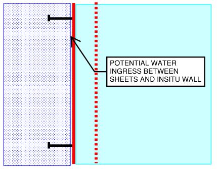

Is it possible to fix stainless shear studs to a mild steel structural element.
I have an application where Id like to produce some composite action between an insitu sea wall and some sheet pile however have durability concerns with the shear studs introducing a corrosion pathway into the wall leading to failure of the connection.
the sheet is heavy gauge for driving/install therefore dont have concerns with corrosion of the external wet face, over design life, however there is a risk of water ingress finding its way to the interface between the sheet and insitu wall and attacking the stud.
would it be possible to use a corrosive resistant stud such at SS or would this cause more issues than it solves via galvanic corrosion of dissimilar metals?
Appreciate any assistance
I would stay with steel, mixing materials has some additional risks.
The concrete will offer some passification against corrosion.
