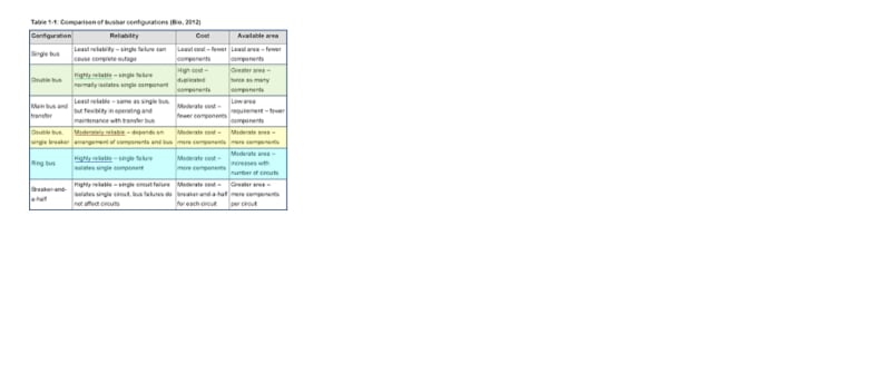

Dear sirs,
I want to design an intermediate substation which can transmit around 555 MVA.
Incoming double circuit 220 kV lines bring power. And outgoing 132 kV double ciruit lines take power.
1. Will single breaker double bus system be sufficient?
2. For high power, we use single phase autotf, so 6*92.5 MVA will suffice I think.
3. If Gas insulated substation, how equipment arrangements continue? I think it starts from lightning arrester, CVT and then?
4. PT can be kept one for each bus?
Please reply,
Sincerely,
Sorry to say that, it is my understanding that this site is just a forum to discuss tech issues but not a "DESIGN GUIDE".
Never understood the concept behind double bus single breaker. Sounds like four breaker rings would fit the bill.
The station configuration AIS or GIS is driven by the system reliability and somehow influenced by the regional engineering practice.
A double bus single breaker is common in the IEC marketplaces but less common in the ANSI región where ing bus is very popular.
See if the table below can help to make your decision in this matter.

Advantage of SBDB is that you get the simplicity of straight bus with the ability take an entire bus out of service without having to shut down any elements. Additions, testing, relayig settings ect are relatively straight forward. Busbar protection and breaker failure is skipped in some countries since it is less essential than in multi breaker designs.
Down side is lots of linear space and of course a stuck breaker or busfault removes at least half the station from service.
@OP: This may help:
While a bus outage is occasionally needed, breaker maintenance should be much more common and DBSB does nothing to help that.
Davidbeach,
How doesn't it help with breaker maintenance? If you isolate a breaker, the associated line can be fed from the other bus. Unlike with ring bus, you could perform maintenance on multiple breakers at once and still maintain service.
Personally, I think it is an expensive design that is more about having a straight forward path for expansion than redundancy. You could just put in a long buses or extend the buses whenever more bays are needed and just plan that into the amount of space needed.
If you want the flexibility of taking out a whole bus go with BAAH and you also have the flexibility to work on one breaker in each of some of the bays at one time. If the implications of having a position out to do bus work are less onerous but you still want the flexibility to do breaker maintenance go ring. If you're just cheap go simple bus.

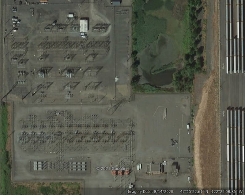

I'd say the reason you haven't missed the second main bus is due to lines swapping outside the substation and/or down stream load serving substations having sources from more than one bulk substation. At least thats what I've noticed looking from above on Google Earth. Though once you head South of Washington State and Oregon, double busbar with breaker bypass becomes the norm in California for anything built in the early 2000s and prior. If the North had a more intensive, less looped network history probably would've favored SBDB.
For example, I found this substation in Tacoma where the 115kv is M&T, but the mostly radial 57kv (?) is SBDB with bypass:

The lowest voltage in that picture is more than 100kV; might be SBDB, but the use of stain bus makes it difficult to see the connections. The higher voltage is a very typical M&T arrangement for that utility.
Yup, humbly the station does looks like strain bus to me. Now that you mention it that could very well be 115kv looking at the insulators from across the street in Google Street view, but ultimately you would know far better than me as I don't permanently reside on the West Coast of the United States. Now, as for Con Edison... :)

The station in the upper half of the picture is 115 kV with strain bus. It was originally built as single breaker double bus with breaker bypass. Although this physical configuration theoretically can be operated half the load on each bus, operational realities meant that it was actually operated as main/transfer. Bus differential protection was a nightmare. This configuration has failure modes with moderate probabilities of complete substation blackout.
The 115 kV portion has been physically reconfigured into two separate buses with a bus tie between them (M-T-M). Planned maintenance outages to half the terminals are overall better reliability than accidental loss of the whole station.
David is correct that the stations in the lower half of the picture is 230 kV main/aux. The main bus has a bus sectionalizing breaker in the main bus.
kartracer087 -Neither portion of Mbrooke's photo has double bus single breaker with third transfer bus. In this region, 115 kV switches tend to be manually operated and 230 kV switches often have motor operators.
