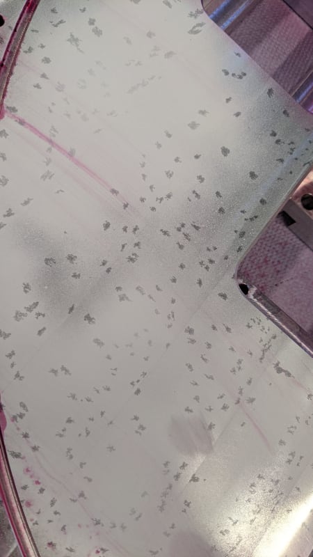

Hi there,
We have recived a machined plate from a manufacturer.
It has some funny stains on one surface. Here some pictures
It is aluminium 7570, 45mm thick
These stains are only on one face.
It seems they have roughly milled the top and bottom faces (I guess to get to the 45mm) and then nicely made the pockets, which have no stains.
Is this rust?
One can't feel it with the nails
cheers,
Did you specify any surface treatment? If not then surface stains like this are par for the course. they might have taken a very light cut off of the rough mill surface.
Do you care about the mechanical properties? Did you restrict what product they could cut this out of? Did it come from rolled plate? Do you know the rolling direction?

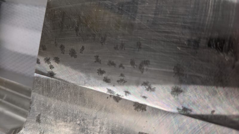

From a distance this looks like it might be formicary or “ants’ nest” corrosion.
Can you supply a close up photo of one or two of the spots?
No surface treatment specified
I care about the mechanical properties. This is a mounting plate holding some load.
I just asked for aluminium 7570. This surface is not important for the use of the plate. But I don't know if it could get worse.
The plate was 50mm. Rolled.
We wanted 45mm so I guess they took 2.5mm on each side

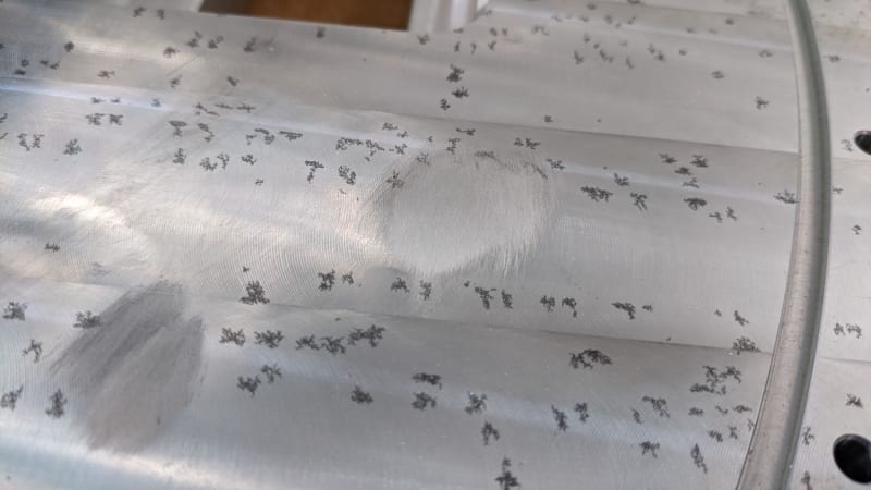

Here a couple of pictures. I can't get them with better quality
This ant nest corrosion looks serious
Apparently happens more often in copper. Here some picture which looks similar:
Do you think this is what we got?
thanks
regards,

Have you tried to dye pen to see if it is into the surface or is it only discoloration?
My hunch is that it is from the cast/hot work steps and they took 4mm off of one side and just kissed the other. Maybe they needed to because of the shape of the original plate.
I'll ask if they can get information from the supplier, maybe they had a bad batch
I thought aluminium is "very" isotropic. How different a rolled plate can be?
The material is T6 / T651 (F51)
Do you mean dye penetration inspection? I never did that. If I spray the penentrant I'll see it going into the stains if it is corrosion?
Whether it is corrosion or surface damage that wasn't fully removed it will hold dye. If it is just staining then it shouldn't hold dye. You might take a flapwheel to a spot and see how deep it is.

More news about the plate:
I found a flapwheel for the Dremel and worked a bit the surface
Here you can see the result. It is not deep.
I think the bad casting process can be ruled out, but not the corrosion
cheers

Don't jump to conclusions about inclusions. The photo evidence could be just an illusion or a delusion, causing confusion.
I agree that crevice corrosion is a possibility. That explains why it's on one surface. If the plate were left flat on a smooth surface the whole face of the plate could become one giant crevice. The moisture source would be the water in the coolant used during machining.

I also did the penetrant inspection
There are no traces of the dye in the stains
But the developer doesn't cover the stains as the rest of the material
Here a picture:
