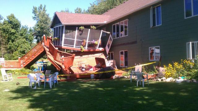

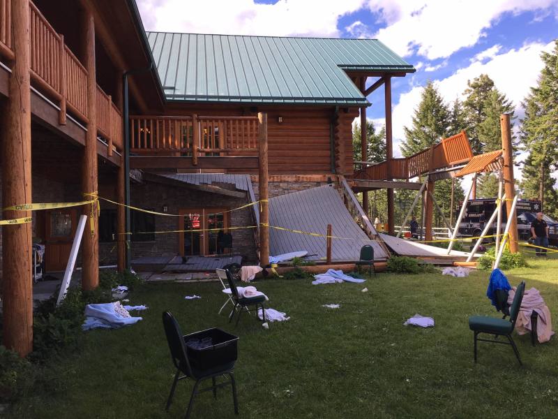

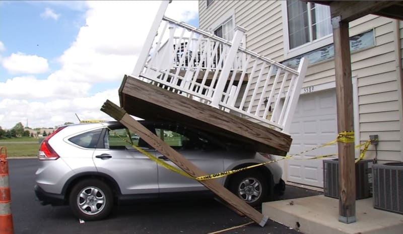

I completely agree with you about gut feel - decks and balconies have got to be the most common structural components to fail (precast assemblies not far behind).
Deck_Collapse_Residential_Forest_Lake_WI_2012August19_-1_from_bemidjipioneer.com_nkites.jpg
Many DIY residential decks should take a 40 PSF uniform live load. The problem comes when a group of people stand close together for a photo (~75 to 100 PSF).
Ask the "deck guy" if he wants to be under one of his decks while a group of volunteers doing a DIY load test.

Nice pictures.[smile] Would I be correct in assuming that some of those failures were fatal?

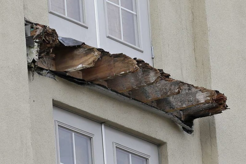

That collection of photos you have - brings back a lot of memories, a lot of those collapses have been discussed on this website, some of those collapses resulted in deaths. The photo showing the seriously rotted out failed joists resulted in 7-8 deaths if i recall correctly, it was university students at a party in the SF bay area i believe.
