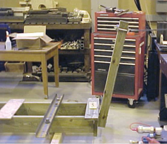

@ KootK. I have thought about suggesting something similar to your load-testing statement in the past specifically in regards to deck handrails. Something like the following:
How about we mock-up your rail detail/attachment sideways, with the rail build horizontal, and you stand out on the far end and jump up and down.. I figure a 250# contractor jumping on the end is roughly equivalent to rail loads + factors of safety.
Most would likely fare something like this.. possibly with the contractor lying on the ground.
