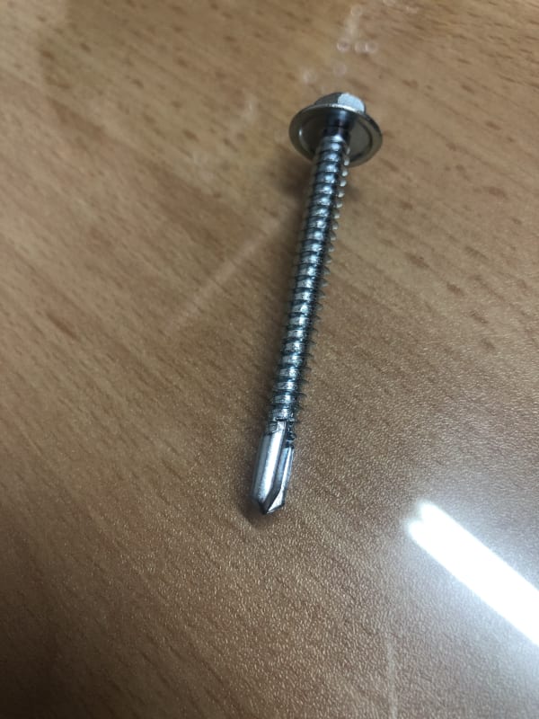

I am making special fasteners from 1022 steel.
The screw needs a high surface hardness (58-60 HRc) but should be able to bend also (5-7 degrees).
In my heat treatment process I get the hardness but the screw does not pass the bend test. It is brittle and breaks.
HELP !

Maximum possible hardness with 0.22 C is about HRC 45 , depending on thickness , austneitizing temp, quench severity, etc, etc. Gas carburizing is the standard process for ordinary steel screws. It seems like you are carburizing to get above C 45.
The screw I am making is a Self Drilling Screw. 1022 is the standard material.
The screw has to be hard enough to cause the drilling (in 6mm steel plate), then the threads have to tap the steel plate until the flange touches. It should NOT break during the process.
I am doing Carbonitriding, Quenching and Tempering. I am able to achieve a surface hardness of 60 HRc (case is 0.2 mm so the entire thread thickness is kind of through hardened). I then bring the hardness down to about 56 HRc in tempering, but the screw still breaks while tapping. The break is about 3-5mm below the head.
Is the tempering faulty ? What can I do to increase toughness ?
A case of 0.2 mm is not thick enough to get a HRc test at 60. The surface hardness should be tested with Rockwell Superficial like 15 N or Vickers with a light load. I think the actual surface hardness is higher than HRC 60. I would gas carburize at a carbon potential of about 0.4 % , then the lower carbon in the surface would not be so hard and untough.

This is the screw.
The drill size is pre matched in the front tip.
I think the picture will answer most questions.

the size and length of this screw is in adequate to drill and tap .236 thick plate. it's going to break., or fail.
need a bigger fastener. and it may need to use a stiff carbide drill. then tap.

Looking at information for these types of screws, generally the screws are limited to a maximum plate thickness equal to their diameter. It seems this is simply the wrong application for the screw. You may also have problems if the threads engage before the drilling tip has passed through the material.
If the length of the drilling tip of the screw (not including the taper on the nose) is less than the thickness of the plate being drilled, your self tapping screw will never tap a hole through the plate without breaking - it's impossible.
When you're drilling, you're creating chips. As soon as the thread touches the top surface of the plate, the hole is closed. The chips have nowhere to go; they will jam the drilling operation and the shaft of the screw will fail. This will happen pretty much every single time unless the bit driving the screw becomes disengaged.
This seems to me to be an application of the wrong screw to the wrong plate, not a problem with the design or heat treatment of the screw itself.
