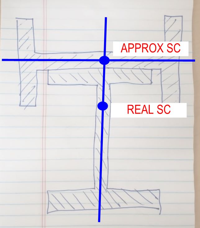

In my industry, fairly tall columns (~50ft) are required with no possibility of bracing and a common style is two wide flange beams stitch welded in a "T" formation as shown below. Required corrosion allowance renders some of these column elements slender as well. It seems that using ASIC 360-16 E7 and E4(b) is correct. A few questions:
Is J = the sum of (b*t^3)/3 accurate with this open built-up section? (Per AICS Design Guide 9)
How do I calculate Cw of the built-up section?
Is there an easy way to calculate the location of the shear center?

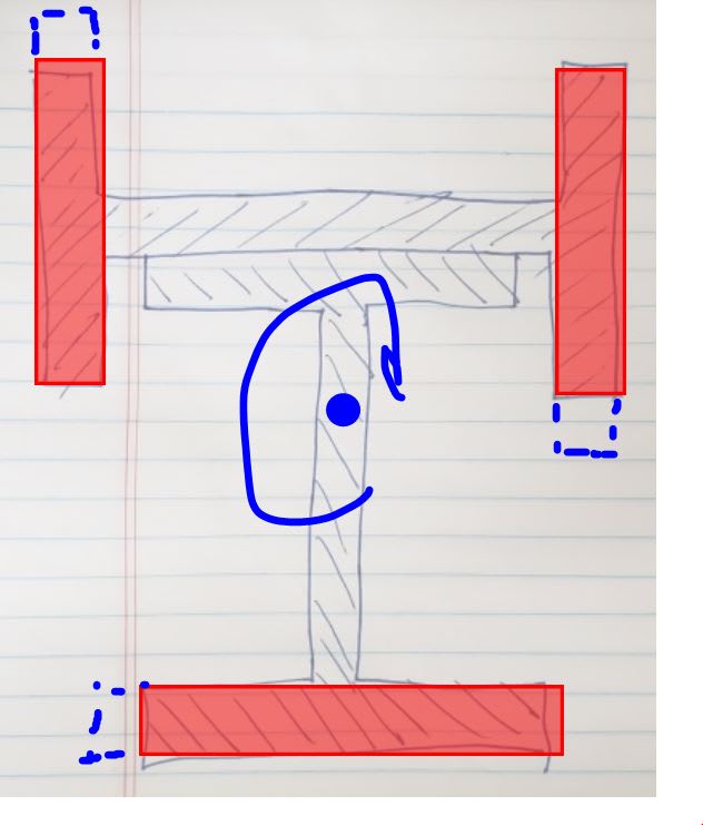

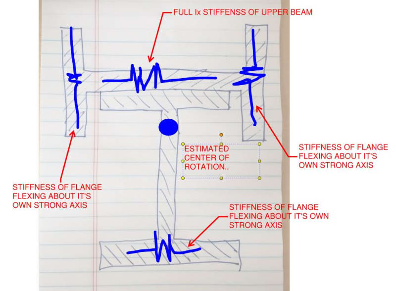

I'd pretend that the section is nothing more than the three flanges shown in the first sketch below to get a reasonable, lower bound estimate. Use that to estimate a center of rotation and then the twist stiffness offered by each flange flexed about its own strong axis. Kinda like shear wall analysis in short buildings.
For many purposes, I'd deem it sufficient to plop the SC right along the two strongest lines of flexural resistance in each direction. This one's a bit tricky though in that, depending on what your doing with the shear center, different estimates may be lower bound for different things. Some judgment is required.
With stuff like this, I try not to get too lost in the weeds of mathematical complexity. How you introduce the load to the member at the top and exit the load at the bottom may wall muddy up some of the results of our spiffy math and FEM munching anyhow.
I think that this has merit for the shear center estimate too, although I've probably butchered the explanation.
This is probably a better estimate for Cw. It should still be lower bound but stiffer than my previous estimate.
