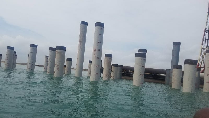

I've seen some piles using spiral weld. Made on site. You might need to zoom in a bit....
