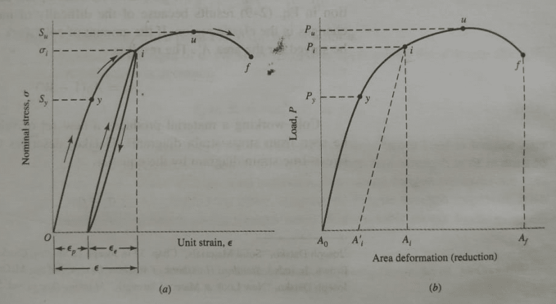

Cold working is the process of plastic straining below the recrystallization temperature in the plastic region of the stress strain diagram. Properties of the material obtained from hot rolling are quite different from those obtained by cold working.
Consider the stress strain diagram of fig. Here the material has been stressed beyond the yield strength at y to some some point i, in the plastic region and then the load removed. At this point the material has a permanent plastic deformation ɛp . If the load corresponding to point i is now reapplied, the material will be elastically deformed by the amount ɛp. Thus at point i the total unit strain consists of the two components ɛp and ɛe and is given by the equation E= ɛp + ɛe.
[img
This material can be unloaded and reloaded any number of times from and to point i, and it is found that the action always occurs along the straight line i.e. approximately parallel to the elastic line Oy. Thus ɛe = σ I / E.
The material has now a higher yield point, is less ductile as a result of reduction in strain capacity and is said to be strain harden.
From equipment’s design point of view we need to consider allowable stress and as per ASME allowable stress is minimum of yield strength/1.6 and ultimate tensile strength/2.35. now since here in the cold working process only yield strength is increasing and there is no change in ultimate tensile strength. If allowable stress of a material happens to depend on ultimate tensile strength then we are not getting any benefit of cold working in terms of allowable stress. So why unnecessarily we spend money to do cold working process for such materials where ultimate tensile stress becomes the criteria for choosing allowable stress.

I wanted to highlight only one issue in the cold working process i.e. yield stress can be increased substantially compared to UTS in the cold working process. So for equipment design if allowable stress depends on UTS only then why should we do cold working. Is there any other advantage of a cold working process ?
Yes there are reasons to cold wrok; you improve dimensional tolerances, improve surface finish, and with many very soft alloys a bit of cold work improves how they machine (they are less gummy).

I think you are looking at this issue the wrong way. It is true that cold working most metals tends to strengthen them, that is, move the apparent yield strength up the stress/strain curve. But, many metals (ductile metals) do not have a well defined and long plastic range or strain hardening range. Many of them go fairly quickly through these ranges, at a fairly high/steep rate, and on up to the ultimate strength. Thus, it requires very careful consideration and engineering judgement to really take much advantage of this apparent design strength increase. I’ve always looked at it as something of a strength increase ‘insurance policy’ when I am designing to yield, but also must recognize that I would be working closer to ultimate strength/failure, with less margin of safety remaining, to fall back on. Knowing I have this ‘insurance factor’ assuming I know the strain hardening level, and thus, the new apparent yield strength, might allow me to push my design closer to my normal yield/design stress, with some greater degree of comfort. I’ve often looked at the mill certs for the material I am using and used those Fy and Fult values for my design values; rather than using the ASTM guaranteed min. values, which is common engineering design practice.
You do generally seem to understand the mechanism around the stress/strain curve and loading a specimen above/beyond yield, unloading, and reloading up to the same point/load, generally following the same (old) E slope from a new zero load strain starting point back up to the new apparent yield point. But, you do not know the actual Fy and Fult of every piece of material before you use it to build a product/structure, and you are also unsure of the strain hardening which has taken place, if you were to try to use that improved/higher apparent Fy as some sort of a design strength.
Under very controlled and repeatable conditions and means of manufacture, with a very controlled virgin product, and with considerable testing and design history, I can see using some higher strength, by virtue of cold working. Many times, at first, cold working is just the most practical means of final manufacture of the raw material. Examples might be cold drawing of wire and bars, some tubing or cold working steel sheet and light plate, coil, etc. But, this is a fairly narrow range of materials, and certainly not run-of-the-mill commercial metal materials from just any steel supply house.
