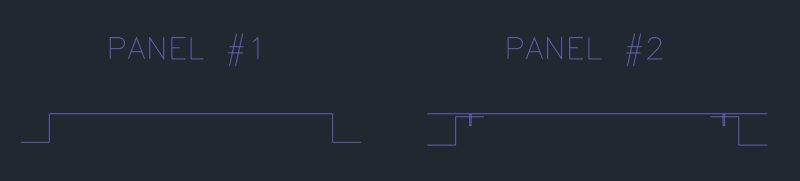

We are fabricating and painting our own panels from aluminium sheets. We currently have external suppliers who bends and paint our pannels, but we will start doing it in house this summer (we have an automatic panel bender and an automated paint line that is being installed).
We have two types of panels, both come in 2mm or 3.2mm thickness. The grade that is presently used is 3003H14, from what I gather because it is cheap.
The first type is simple two-bends ("Z" shaped) on the whole permieter which gives us a lip to screw to (usually) omega bars. The screws remain visible for this type of panel.
The second type uses welded studs to fix aluminium extrusions ("Z" section) which is then used to fix the panel. The screws are hidden for this type of panel.
All dimensions are unique, they are measured on site once the windows are installed. The panels are rectangular or square, and can go from 1' x 1' to 5' x 10'. I ran some quick calculations and I don't think there is any way to justify the 5' x 10' without reinforcing (I'm getting 6" of deflexion at mid point).

I recall years ago seeing panels similar to #2 that had transverse stiffeners mounted to the same studs as the edge strips. The stiffeners were top hat shaped and there was a glue to prevent rattling.

Most of the information I can give you now is contained in the post and discussion with Kenat. I was responsible for fabricating 1/8" (3.2mm) siding panels with welded corners, erected on frames made of perforated channel. We also made 1/4" ( 6.5mm) laminated (Reynobond ) panels. Although unlike Grenfell Towers, anything we used more than 10'-00" above grade had a self extinguishing core. I have been retired for 9 years now and am rapidly losing touch with the latest industry practices. Stay away from 7075 it is expensive and has poor corrosion qualities

For the most part no. When we did jobs like this, the building was measured, and the framework was designed and drawn up in CAD ( Solidworks.), the panels were then designed so that where possible the edges of the panels matched the flanges on the panels. These were assembled in Solidworks to check for conflicts Adjustments made as needed, then sent for fabrication, Studs were only used when there was no other way and holes in flanges were kept at 2.5 hole diameters.Or on the centerline of the flange.
