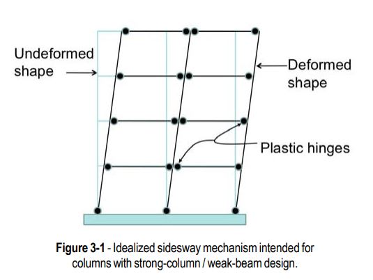

Part of the general philosophy of seismic design is to encourage the inelasticity in the beams and discourage it in the columns. The idea is that when beams go inelastic, the structural integrity is NOT compromised. And, in a post event repair, it is much easier to replace a beam than a column. However, if you introduce a hinge in the column, then the gravity load carrying system may be compromised. The caveat to this is at the roof level where it's not uncommon to reverse the moment connection and force the inelasticity into the top of the column.
The same generally applies at the base of the columns as well. Foundation and baseplate stiffness relative to beams/column stiffness in the first storey often forces a hinge near the base of the structure. Provided their is no corresponding hinge at the underside of the first level you don't have a soft storey.
I don't think doing the same dogbone detail to the base of the columns is appropriate, nor warrented.
I suspect that Althalus' point is that most conventional, steel moment frames require plastic hinge formation in the columns at the base in order to form a complete mechanism. Mechanically, I dig it as a means of forcing the hinge location to occur away from the base connection where behavior tends to be less predictable and more subject to non-ductile failure modes. It's not as though you'd be sacrificing a meaningful amount of axial capacity in most situations.
The dogboning has a real cost associated with it so, I agree, we'll not be seeing it at column baes unless the engineering community comes to feel that it is warranted for technical reasons. Frankly, I wouldn't be surprised to see that come to pass over time given how complex the joint behavior is likely to be and how little of this stuff has been tested and/or tested at anything resembling full scale.

A column dogbone would:
1) Make for a nicely predictable plastic hinge mechanism.
2) Allow one to shield the base connection from potential damage, as we do with beam-column connections.
3) Reduce the flexural demand at the base connection where it would be designed for capacity / overstrenght.
That's all I'm saying.

The plastic hinge at the base occurs after the levels above have formed their hinges.
I wasn't aware that we knew the order of operations with any particular certainty. What informs your opinion on that? I would have thought that it would depend on the proportions of the frames, the proportions of the frame members, and the relative base fixity expected.

The column then cannot be loaded higher than all the loads flowing into it. So, the column is also given some reprieve from the beams having a reduced section.
This was a new direction of thought for me.
I don't tend to like the idea of a dog bone close to the base. Shielding the base connection from damage seems odd when you're forcing the damage into the column instead.
That being said, the idea of reducing the plastic demand at the base is kinda nice. How about alternate ways:
