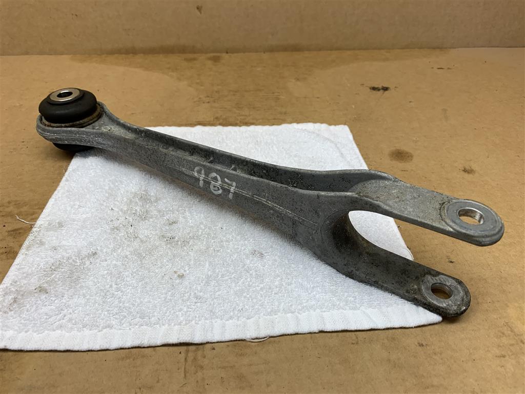

So I am looking at the method in general, but I will try to give you an idea of the type of parts if could be used for - these are just generic examples.
The fibre could be UD down the length of the arm and flow in a circle around the eyes.
Similar to the above apart from the fibre would split at the fork and extra fibre would follow the large curve at the fork.
The fibre placement would be along the path of stress flow from the bottom attachment points to the top.
As mentioned, for all these examples the fibres are just imbedded in the matrix - no layering/plies.
