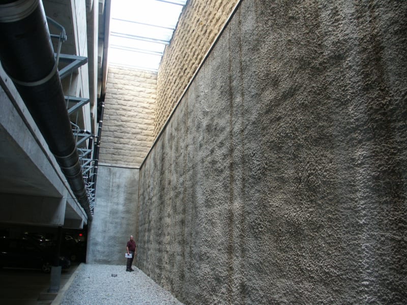

I designed a similar wall. The anchored wall had a temporary height of up to 28 feet with an MSE wall directly behind the anchored wall. The MSE wall has a height of up to 33.33 feet on top of the anchored wall. The MSE wall has big facing blocks with geogrids. I got the actual bearing pressure distribution under the MSE wall from the MSE wall designer and applied it as a vertical surcharge to the anchored wall. The anchored wall's finished height was 24 feet. It used double WF soldier beams at 4' on center with one and two tiers of tieback anchors. Remember, the surcharge from the MSE wall is greater than just the uniform dead load of the wall. As the MSE wall wants to resist overturning, the bearing pressure at its toe (which will load the anchored wall) will be higher than a uniform dead load. My job had an MSE wall bearing pressure of up to 5,325 psf, significantly higher than the wall's uniform dead load.
See the picture below. The anchored wall has a shotcrete facing over the "temporary" timber lagging. The beige wall above the shotcrete is the MSE block facing.
