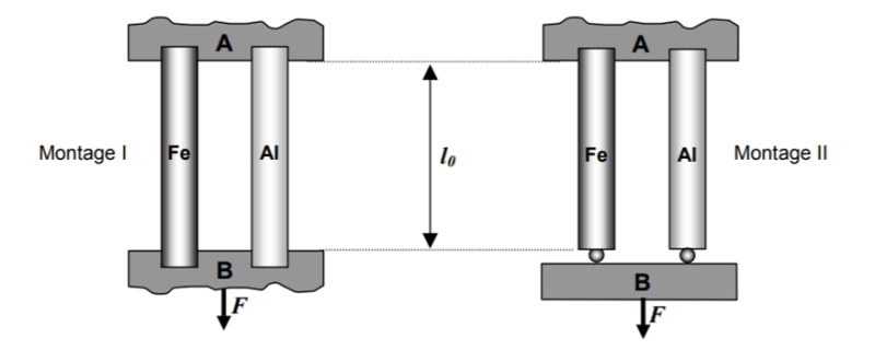

Hello everyone, in one solved problem in Strength of Materials, it was mentioned that the applied force on each bar for montage II is F/2 , even though they're made of different materials : Steel and Aluminum. Can you please explain to me why ? I'd be really grateful .

I assume the two bars have the same cross-sectional area.
If there was a mechanism that held member[ ]B exactly parallel to member[ ]A, then the two bars would see the same strain, and the less flexible steel bar would see three times the stress, and force. The elastic moduli are Esteel=210GPa, Ealum=70GPa.
In the absence of such a mechanism, this is a simple statics problem, and the two bars see the same force, and same stress. The aluminium bar will see more strain, due to its lower elastic modulus.

Another way of looking at it (repeats what drawoh just said, in different words).
Stop thinking about strength of materials for a second. Just look on member B and its three attachment points as a simple lever.
Once everything has finished moving, the only things that affect the forces in the specimens are the applied force, F, and the relative distances of their attachment points from the point where the force is applied. If both distances are the same, the forces will both be the same.

It is clear what the writer is trying to illustrate. Force F is half way between two bars and the reaction is F/2 for each bar. It is not necessary to assume the bar areas are equal.
Small deformations are ignored in this analysis. If the right bar stretches more than the left, Bar B rotates clockwise, moving force F vertically downward and to the left (closer to the Fe bar). The magnitude of horizontal movement depends on the depth of Bar B.
So, in practice, the bar with the larger A*E will take a little more load.
BA
If the top supports in Montage II are considered fixed and the bottom connections pinned, differences in bar properties, specifically A*E, will produce variable tension and bending moment in the vertical bars if small deformations are considered.
