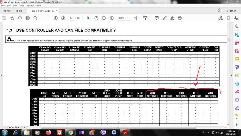

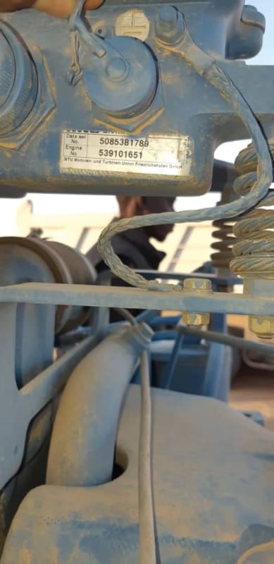

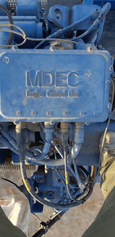

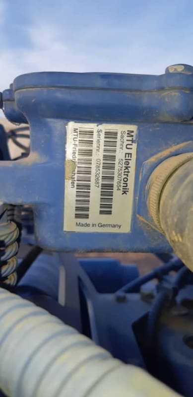

There's one more thing. in can guide file dse there's a table of ecu engine with compatible dse controller. However the 7320 is configured only with 3 versions of mdec ecu from 5 versions. And I can't know which version mdec I am dealing with.
Maybe that's the issue.
so if any could identify the version of mdec tell me so I can buy the compatible dse controller
Here some photos for the mdec and can dse guide table.
The MTU dealer should certainly be able to answer your question about which MDEC you have based on the serial number you posted.
There is a manual available online with a "plant specific configuration". Perhaps it's worth looking at?
It does seem that some MTU MDEC controllers are not SAE J1939 and are read-only on the CAN so that would explain the compatibility differences.
