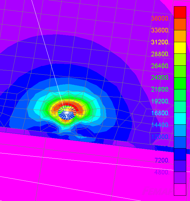

Not exactly aircraft engineering, but I believe this group would have the best understanding of these topics. I work for a small company that typically designs fixed GSE. However, we are working a skid mounted project which we must verify against transport loads per MIL-STD-1791. Being that I typically work on the ground side, I'm a little less familiar with the nuance to how the Limit/Ultimate loads are handled with respect to margining. I was hoping someone may be able to clarify on a certain scenario, which I feel must be common, although I could not find addressed directly in another thread.
MIL-STD-1791 states that "Item function must be maintained up to limit load" which I interpret as meaning yielding cannot occur which prevents use of the device under the limit load case. I have generated a FEM model of our skid and at limit load there are some small areas around a set of bolt holes above the elastic limit. Running a non-linear analysis with perfectly plastic material model (A36 Steel) shows that plastic deformations are very small (0.001 - 0.002 in) certainly not enough to affect the function of the part (supporting a large hose reel). This being the case I am satisfied the design is adequate for limit loads.
However, how does one populate a margin table for this scenario? Being that I am at/above the elastic limit, it would seem margins are zero/negative (even though I think this is totally acceptable). My thought are to either:

If you modelled the actual holes in the FEM and connected to a fastener node with the usual wagon wheel rigid element approach, the local stresses are probably fictitious/wrong and should be ignored. But need to see a picture of the modelling details and results.
SW,
Correct, I am modeling with rigids at fastener hole and agree the rigid will introduce artificially high stresses. Honestly, I am always a bit fuzzy when to draw the line as to when nodes are far enough away from the rigid that results are no longer fictitious. I provided an image below, the yielding spans back a few elements off the rigid, deformations are low. There are a few spots similar to this one. Hole is 0.75 in for reference. Plot is averaged, nodal, von-mises plate stress.
I personally feel the situation is fine, but am a little uncertain how to convey that to an aviation oriented reviewing body.
Sigh. Extract the fastener load. Calc bearing stress as P/dt. Compare to Fbry. If positive margin, good to go.
I don't know if I would immediately agree with simply using the fastener load that way.
First off, P/dt is not always the most accurate bearing area, depending on what is actually happening to the fastener. Also, you need to determine... is the stress so high because of load transfer, or because of something else?
The stress plot you show above - are those the results from your linear model, or from your "non-linear analysis with perfectly plastic material model"?

SW, thank you for your guidance. I was intending to extract loads to margin the fastener and associated checks, but was maybe overthinking how far from the rigid should be ignored on the base part. I have heard to exclude the first 2X rows of elements around a fastener modeled this way, but maybe that is overly conservative.

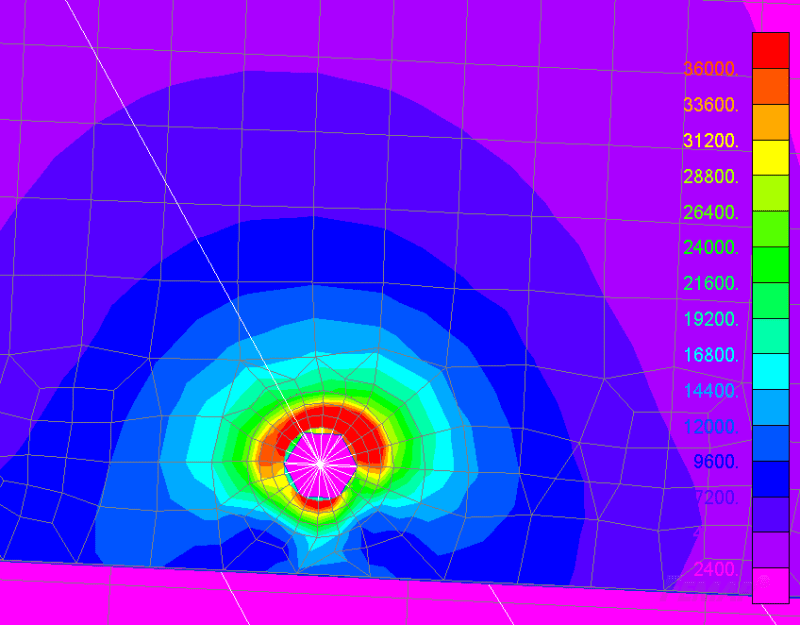

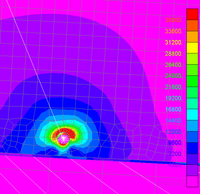

LiftDivergence, for completeness:
Linear:
Non Linear Perfectly Plastic:
both are scaled to yield.

it is a shame that we let pretty pictures beguile us.
FWIW, my reading of MIL-STD-1791 states that "Item function must be maintained up to limit load" does not preclude insignificant localised yielding (such as occurs at every hole in every plane). Would this localised yielding affect the function of the "item" (I hope not) ?
We should recognise that these stress peaks occur and plan to clear them with a hand calc (bearing).
I just don't think I personally have enough information to recommend a simple bearing margin against Fbry.
We are woefully light on details...what is this fastener? What parts does it fasten together? How is it loaded? What does the surrounding fastener pattern look like?
Clearly there are some artificial stress values which result from the way the model is constructed. And standard geometric figures obviously create peak stresses which are not generally detrimental to the net section.
However, I think the first step is to understand why the results look like they do. Just saying it's a hole, you have an RBE connected to those nodes, etc, just write it off based on bearing stress calculation - that can be just as bad practice as blindly believing the stress contours.
I don't think it is unreasonable to want to see the comparison of the plots linear vs non-linear. It is interesting that there is very little difference between those plots.
For example, if it actually is an issue of bearing, then why is the peak stress on that side of the hole? It looks like some kind of lap joint with the edge of the part clearly shown. So which way is the load acting?
