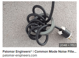

This will sound strange - if the noise is in the shield of the connecting cable, try winding the cable around a wooden doughnut (torridal choke) I did this once with a welding work lead to solve a noisy welding machine that was interfering with a radio.
Something like this
