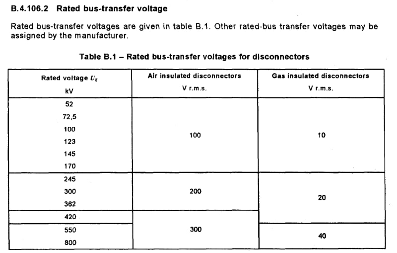

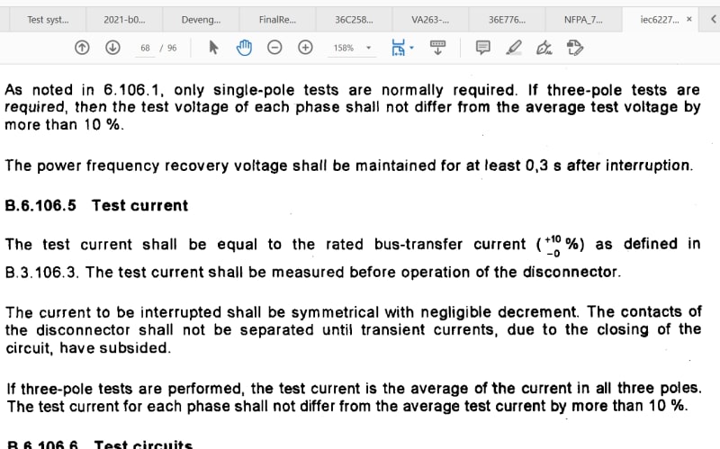

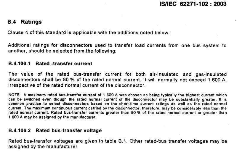

Not true, IEC 62271-102 Annex B does list the current at 80% of rated normal current with a voltage of 100, 200 or 300 volts:

Bus transfer is supposed to be without interruption. This is the definition from IEC
"3.7.122
bus-transfer current switching
opening and closing of disconnectors under load when this load is not interrupted, but
transferred from one bus to another"
With regard to the ability of disconnectors to make or break negligible current in general, see below from same IEC:
"8.102.5 Selection of a bus-transfer current switching capability for disconnectors
of 52 kV and above
Although disconnectors are, by definition, only capable of opening and closing a circuit when
either negligible current is broken or made or when no significant change in the voltage
across the terminals of each of the poles of the disconnector occurs.."

Now, in single breaker double busbar*, with the buscoupler closed, the voltage between bar A and bar B is typically around 100 volts.
Some isolators can break several thousand of amps at 100 volts when transferring between bars in closed transition.
I say some, because ironically attachments like whips, whiskers, ect designed to increase current dropping capacity at higher voltages can actually melt from the several thousand of amps of current.
And of course some switch designs will pit or wear out more breaking 1000 amps at 80 volts.
