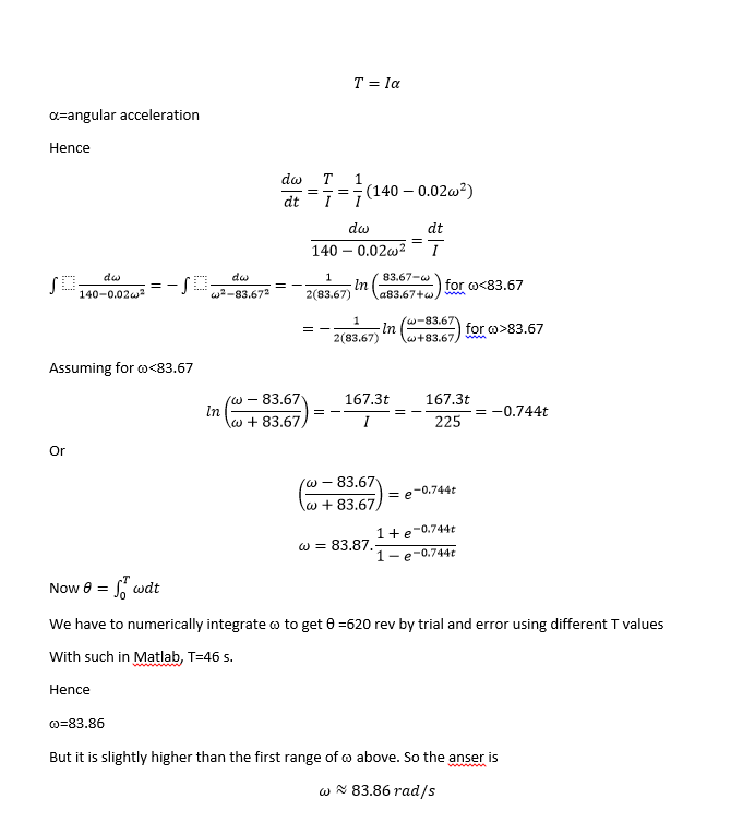

A Dynamics question
225*dw/dt=140-0.02w^2 They don't give units for w so the intended answer is anyone's guess. rpm, deg/s, rps, rad/s?????
I'd solve it numerically, but it doesn't look too horrific to solve with calculus.

I'll bet you could solve it by laplace transform method.
looks like homework.
(2B)+(2B)' ?
This is not the place for homework answers.
The other part you should try yourself.
