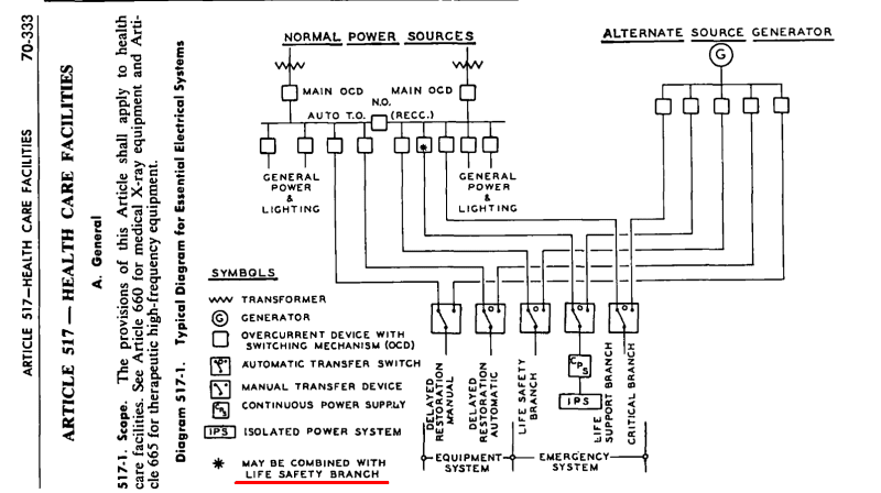

The NEC from the 70s had an allowance for a life support branch in addition to the critical branch- and the fact a fair share of pre 80s hospitals actually had a dedicated life support branch in conjunction with a separate critical branch.
From the 1971 NEC:

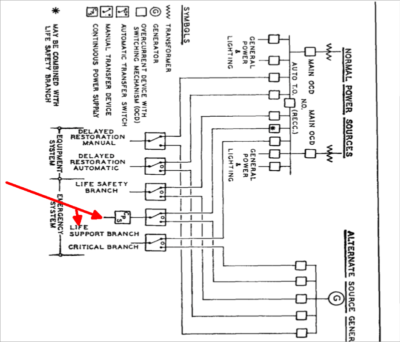

Graphic in the ROPs:
It is interesting to note that the CMPs originally agreed that the life support branch could be combined with the life safety branch if they were not separate.
1971 ROP:
The life support branch was originally intended to receive the same fire protection and priority as the life safety branch which was (and still mostly is today) required to meet the requirements of article 700.
Latter on the CMPs changed their minds that the life support branch could be combined with critical branch instead of the life safety branch.
For the 1978 NEC a proposal was sent in to delete the concept of a life support branch:
Accepting the proposal was a fantastic impulse without any thought and hare-brained to be frank.
It took away the concept of a protected high priority branch that not only should/would have followed article 700 but also the greater probability of getting rid of the half and half approach in ORs and ICUs during design.

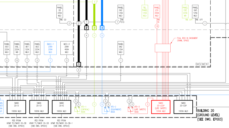

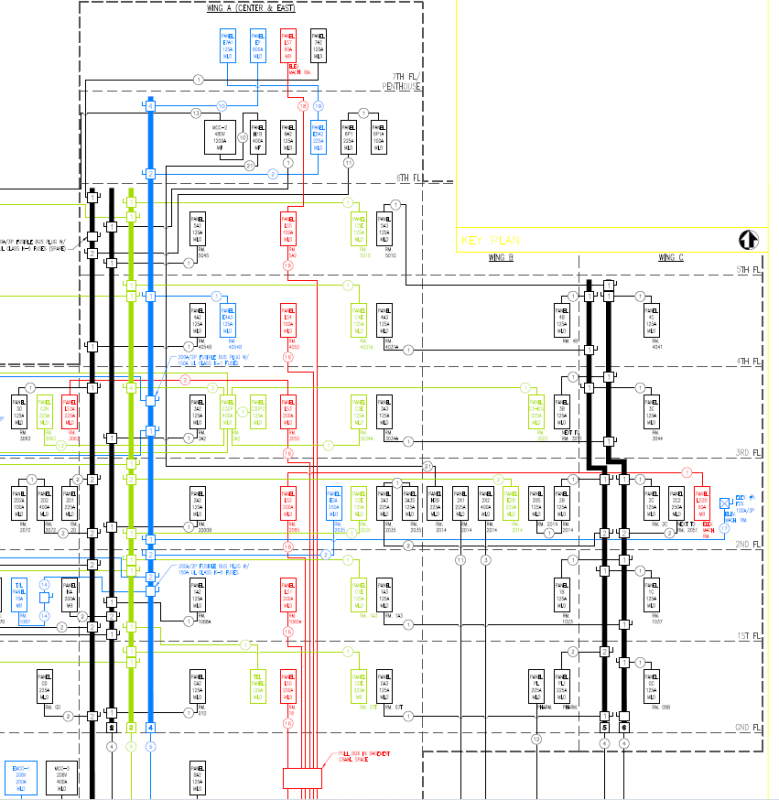

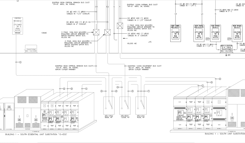

How it translates into the real world- as typical:
(Black = Normal, Green = Critical, Blue = Equipment, Red = Life Safety)
Going up the building.
Life safety is concrete encased, in a dedicated segment of the building's core, run as individual circuit feeders (events above can not remove circuits below), branch circuits covered in fire proofing run flush with columns or floor diaphragms above the sprinkler line, and panels are in separate electrical closets.

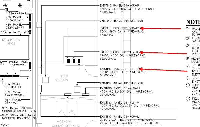

Normal and critical on the other hand are run as exposed bus duct in the same electrical room. Branch circuits are without reservation and unprotected. No fire protection or physical segregation- code does not require it.
A fire or catastrophic failure of the normal electrical system can remove both critical and normal power.
Normal and Critical bus duct within inches of each other:
