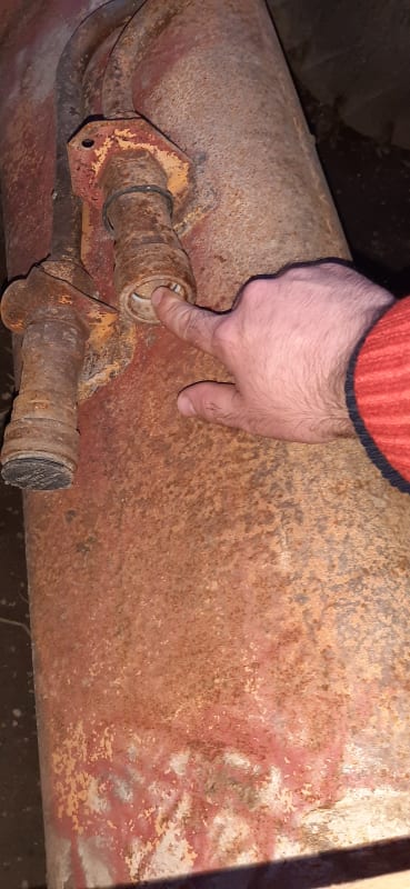

Loader have at the front where bucket is attached 2 metal pipes with quick connections for hydraulics ,it can power double action cylinders.I can send picture of this tomorrow.

The connections on the bucket are very unlikely to be able to be used for a such a device. They tend to be for extra cylinder things like chopping action or moving forks apart, not powering a pump continuously.

What do you think about connections ?,not enough flow or ?.Maybe he could somehow override distributor and directly to power hydro motor from pump.
If that motor on picture i posted is only 20kw ,then it's not enough power ,i guess ?,i just post it as what he did find first for sell,we can search for large ones np.
You need to figure out where the hydraulic pipes go from your fairly big hydraulic pump via some sort of flow controller or switch.
Any connectors I normally see on the front are for other things which are controlled from buttons on the joystick, but your loader might be different.
You really need to find the hydraulic diagram for the machine.

Pump is almost new,loader is mechanical one,only electric that he have is working lights,generator and starter :D,but i will see with friend about flow controller,he have spare parts catalogue for machine and operating manual.

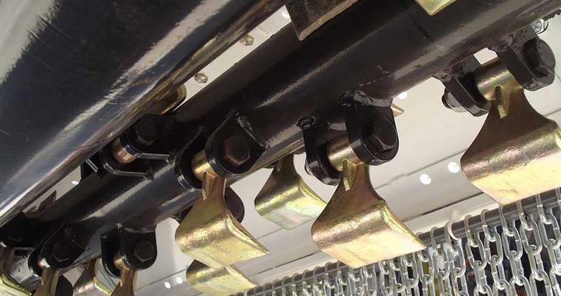

We both are farmers we have tractors all sizes,but they can't do the job,we have some high bushes to cut,nothing thick,maybe max 2 inches at ground level,even less ,usually just 1 inch thick ,and anything above is just thin branches ,very intertwined to say ,u cut it at ground level,with tractor as example,it just keep on standing ,it's up to 5+ meters height those bushes ,tractor can make tunnels trough them easily.Thats why only way to mulch those bushes is in layers,up first,then middle,then lower section,and that can be done with excavator equoped with mulcher, or in our case ,loader.Companies that are doing this job ask for +- 1000 euro per hectare,i even called few more numbers today,they are all more or less at same price level.For the price we would pay some company to do this job for us ,we could easily buy mulcher,hydro motor,oil coolant ,and few other stuff that is needed to equip this loader to do job for us.Plus,we later have working tractor mulcher(when we remove hydro motor) that can be pto driven,which we would have allot of use on our farm fields.

Yea that looks like those axial piston motors ,problem is only that mulcher is heavy type ,this on pictures bellow is rotor of ''mulcher'' we would need to buy anyway for our farms,he requires much less power to operate.
