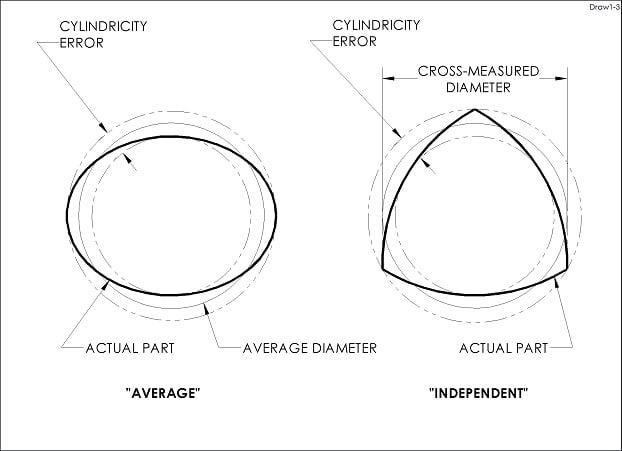

No... the diametrical difference of 0.2 does allow the cylindricity error to be 0.2 (even though a cylindricity tolerance is indeed a radial separation, in this case of 0.2).
I know that sounds contradictory, but the reason is that -- without a GD&T callout for cylindricity -- the size tolerance alone allows the form error of 0.2 to appear as a single bump/lobe all on one side.
Attached is a graphic that has a different example but you can see how the form error is biased to one side. So the diametrical error equates with what circularity or cylindricity perceives as a radial error.

Average or Independence ... and sky is the limit:

Hi Kedu, yes, you were right there is an AVG callout next to the symbols.
According to ASME Y14.5 2018
8.5 Average Diameter
"An average diameter is the average of several diametric measurements across a circular or cylindrical feature. The individual measurements may violate the limits of size, but the average value shall be within the limits of size.Typically, an average diameter is specified for parts that are flexible in a non restrained condition."
That explains why the individual measurements exceed the tolerance 70.1, but the averages are within the size.
I have to study ASME Y14.5 more, very informative.
