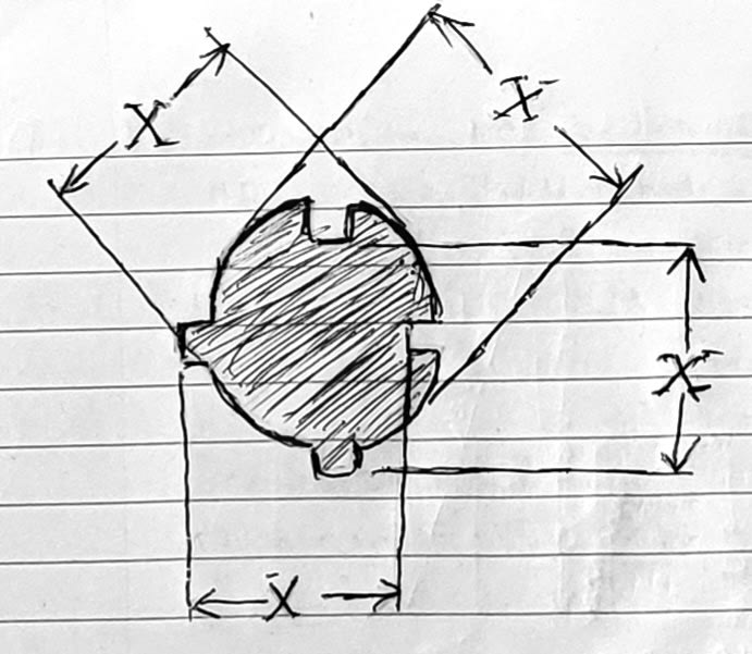

Evan said:
The figures in Y14.5 for size and straightness still only show side views, and do not show what happens within the cross section.
Although I got all the answers I wanted, I still don't understand why the straightness error on the axis will affect the form (circularity, cylindricity). I'm really looking forward to someone being willing to provide a sketch on this “cross section” to interpret how it works.
3Ddave
Is this what you said “a picture is worth 1000 words”.
Thanks again
Season
Season,
Draw something like this in CAD with dimension X being 18, and a circumscribed circle 18.8 (because the VC boundary for straightness limits the form along the shaft and at every cross section without rule #1 intact). Then you figure out what the possible circularity error is.

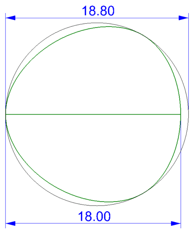

SeasonLee,
Here is another example of what can happen within the cross section. The Straightness tolerance cancels the Rule #1 boundary (18.4) and imposes a larger boundary instead (18.8).
The actual local size can still be as small as 18.0, so the feature can be lobed more than it could with the Rule #1 boundary. The circularity value in this case is 0.8.
Evan Janeshewski

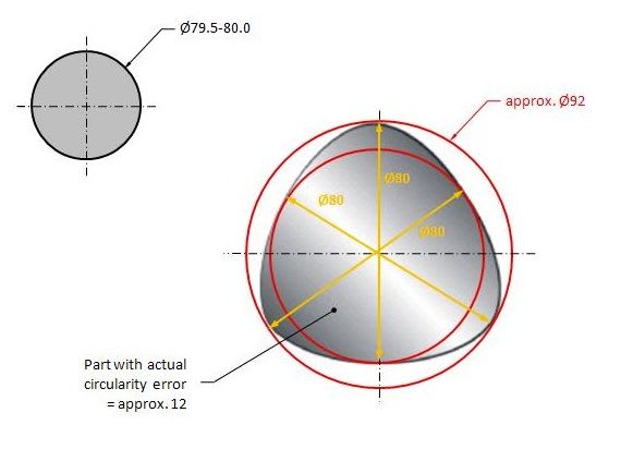

Evan (axym),
How do you know that the circularity value in this case is 0.8?
Asking to clarify my own doubts.
I attached two threads:
Per this discussion, seems a little off your calculation.....

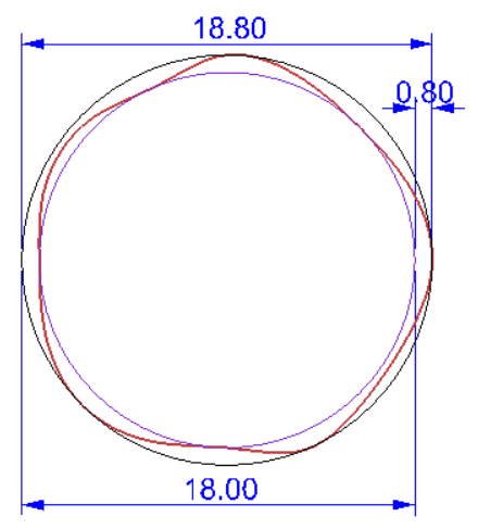

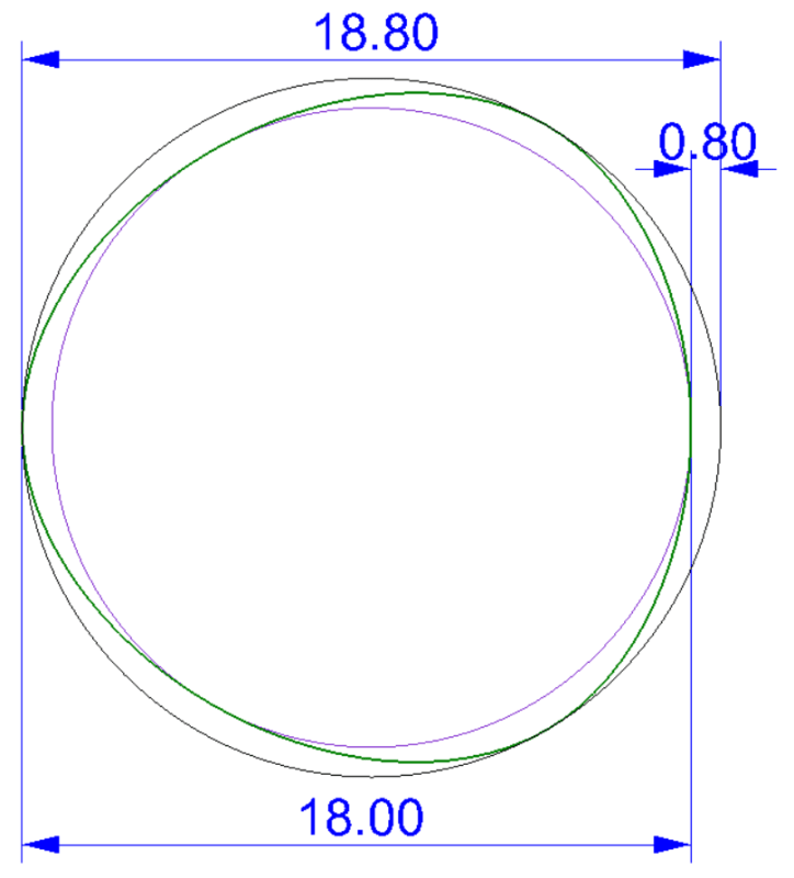

greenimi,
I know that the circularity value in this case is 0.8 because I drew the feature that way ;^). Here is another figure showing the two concentric circles for an actual circularity zone:
This analysis contains the assumption that an actual local size is a 2-point diameter. What specifically did you think was off in the calculation? I haven't had time to read through the thread you referenced.
Evan Janeshewski
I think greemini's last figure taken from the referenced thread is misleading in a way that when talking about circularity, the true profile of the part's cross section is a circle. The actual profile could be something that LOOKS LIKE a lobed part, and not one that's DESIGNED TO BE a lobe. Like that filleted tri-lobe. Or the Reuleaux triangle that's also mentioned in that thread.
These are not circular parts thus calling out circularity, or even PROVING circularity is VERY MISLEADING. They are wrong examples of explanation.
Wushee,
Interesting comment, I didn't think of the rounded triangle shape as being intentional but I suppose it could be. There are definitely situations when the shape was supposed to be round but was accidentally produced with the tri-lobe shape.
The figure doesn't have to be a 3-lobed shape - it's just the easiest shape to draw ;^). The cross section needs to be lobed to a certain extent, in order to show the maximum circularity error. There need to be high points, with a corresponding low point on the opposite side. But the shap doesn't have to be a Reuleaux triangle. Here's a more randomly lobed shape that shows the same effect:

Evan, my problem is that many textbook examples show an extremely lobed polygon (likely purposefully, but it's confusing), others copied it therefore people on the forums got into arguments and started drawing more extreme examples based on the 3 lobed polygon and they've arrived at the Reuleaux triangle and co.
For explanatory purposes, showing low-high opposing points is good, but one must not forget that in the real world, most circular parts would look something like this instead:
