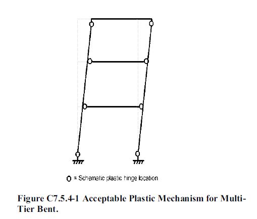

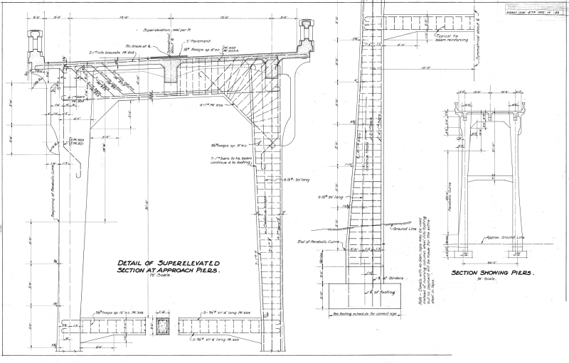

See below. This antiquated bridge we widened several years back was the only one that I am familiar with in my area that used bracing between the bent columns. When we ran the pushover analysis, we did indeed use the plastic hinging of the bracing element as a source of dissipating the energy. We have designed other 100ft tall bridges from scratch that had no mid-height bracing.

This could an option but what is your plan to make sure that the plastic hinge formation will follow a sequence and latest hinging will be at bottom?..
This snap from AASHTO Guide Specifications for LRFD Seismic Bridge Design..

Do you have typical section oh how to make sure that the PH will occur on the bracing, not on the column?

For my project, the brace was already there. I tried figuring out the intent of the original designer but never was 100% sure what he was trying to achieve. That bridge was a bit of a work of art designed by a locally famous Engineer back in 1933. This was long before seismic analysis was ever even considered.

3. Midheight brace should be detailed to ensure plastic hinging in the brace before the column. Obviously, regulating the section properties and % of flexural reinforcing is the way in which to do this. It will be an iterative process to arrive at the results you are looking for as it is a balancing act of satisfying the sequence of forming the hinges and still remaining within the target displacement. There are some elastic static analysis runs you can perform to preliminarily size your midheight brace within the ballpark prior to running the pushover analysis.

- emphasis on the "regulating the section properties and flexural reinforcement", right on track this must be done to ensure PH in the bracing. One question is how do we ensure in the analysis that the connection will enduce PH in the bracing?
Skywalker
Young Skywalker,
To actually verify when and where it plastifies, you will need to run the response spectrum analysis and necessary moment curvature analysis of the different sections. From the RS analysis, you measure your displacements, and then run the non-linear pushover and match your displacements between the two. Plastic hinges may form along the way at different points within your frame.
