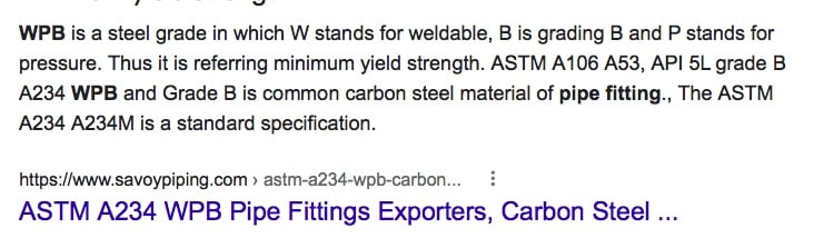

What is the meaning and details of WPB in the piping system?
As Google below:
