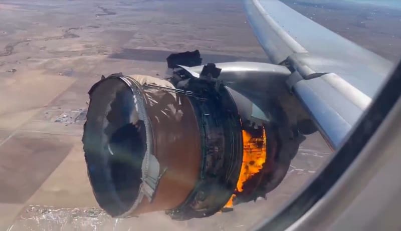

Prat and Witney. Actually looks like it did its job pretty well no damage to the aircraft. and the casing intact.
I presume the flames are from burning carbon fibre and the engine oil.
The burning areas are the carbon/epoxy cascades, part of the thrust reverser.
The inlet, fan cowls, most of the thrust reversers all departed. Not good. This is not supposed to happen in a fan blade out event. Though its not clear what part of the engine failed.
I don't think it was a fan blade or compressor cutting loose . Technically all that stuff that's missing can depart and its still classed as a contained failure. But I agree not good.... But could have been much much worse.

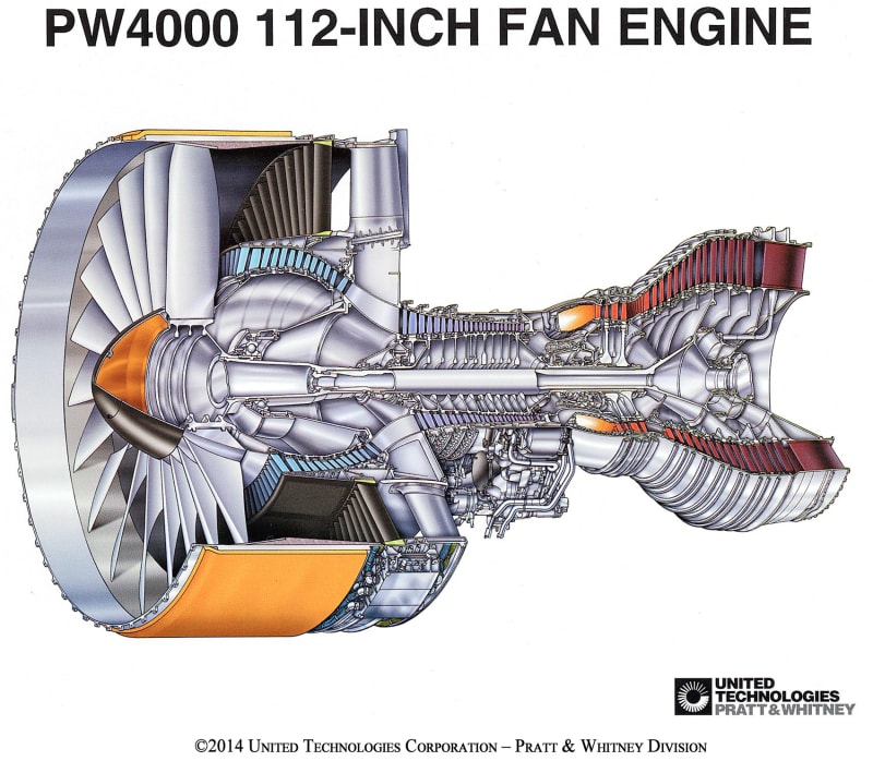

They have a colossal bypass so the core is only about the size of that black dome on the front of the fan.

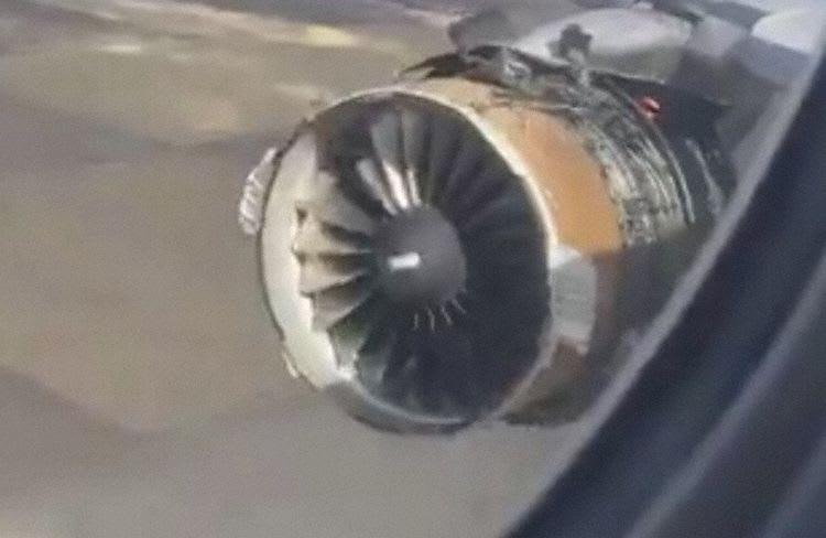

This picture, from The Aviation Herald article that Eufalconimorph referenced, appears to show a missing blade from the primary fan wheel:
And here's a cutaway of the Pratt & Whitney PW4000 engine used on the B777-200:

Your right John one is missing...
To be honest I would call that a failure but colossal success nothing hit the aircraft.

An engineering success, I think. Nothing is 100% reliable and this was one of the worst kind of failures for a jet engine and it ended without any injury.

Not a success. By design and regulations the nacelle is not supposed to depart in a fan blade out event.
They pretty much always do come off though. And if they didn't the shear bolts would go and the whole pod would come off due to vortex shedding vibration.
As long as a blade doesn't come out and bang through the hull pretty much every pilot would count it as a success.
