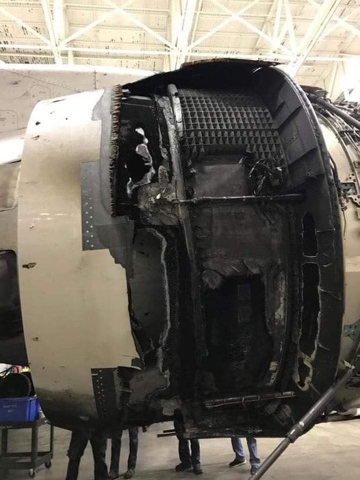

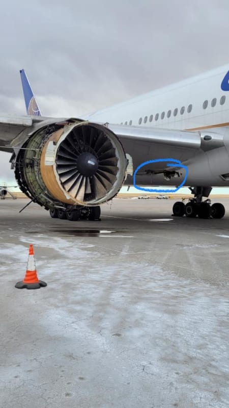

A couple of pictures online today
Brad Waybright
The more you know, the more you know you don't know.
interesting lenght at which the blade let go.
possible that would be a resonance nodal
while the news reports concerning the "fire", seeing that engine unblance shake was what would scare the hell out of me
Look closely. One blade missing, the next one broke in the middle. Reportedly the blade fragments remained contained within the engine. The fairing damage may have been caused by some parts of the nacelle. Maybe not.
Brad Waybright
The only requirement is that the fan blades are retained. The rest of it is not protected. The hole in the side and the damage to the aircraft all come from other bits separating. That bit of the hull though is not pressurised.
