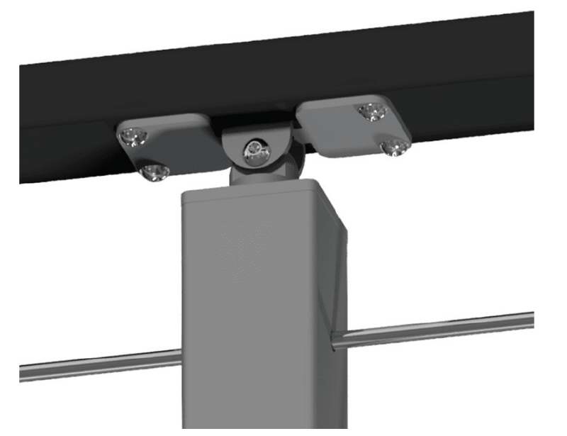

I too don't like the design. I tried very hard to get the owner to go with several other different types of railings. In the end, the board members of the golf course wanted it as open as possible for visual affects. Putting my feelings to the side regarding the railing type, if I am forced to design this type of railing, I at least want it to be correct and something that is going to last. This will be installed directly adjacent to the ocean.
IRstuff,
The example companies you sent were exactly what I am having issues with. You don't find those cheap and flimsy looking? The top railing gets connected to the bracket via some self tapping screws. Crevice corrosion looks to be very problematic with the bracket detail. They also use plugs at the ends of the top rail and all joints are merely miter cut and butted together. How is water intrusion not a huge issue? Don't get me wrong, if I was installing this by myself at my house I would be very happy that it existed but I would never even consider it for a municipal owned project and I am seriously questioning it for a private commercial job.
