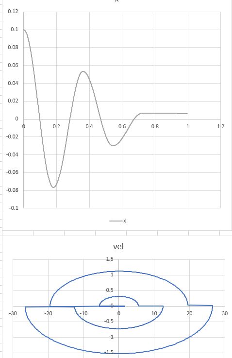

the problem is trivial to set up in a general sense:
The formulas you've shown are solutions to the homogenous equation
replace the zero on the rhs with your forcing function, which can be derived from the vibration profile of the unit. and solve for discrete time periods broken up by the direction of the oscillations (bc of the sgn function)...
... But I don't know how useful this would be for you - it seems like a long and tedious way of not directly solving the problem... And would be very difficult equation to solve if the motor vibrations are from a dynamic speed range and not steady state...

Coulomb's is not "stick-slip." If it was the friction force would show a sudden decrease, more of a stepped square wave. What that graph shows is a constant friction removing energy proportional to velocity until the energy is finally exhausted and the part stops off center. Notice in the diagram the friction component is constant and in opposition to the motion.

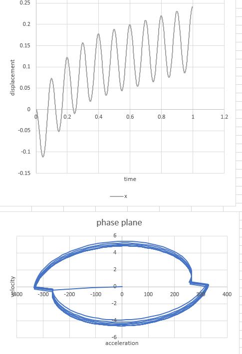

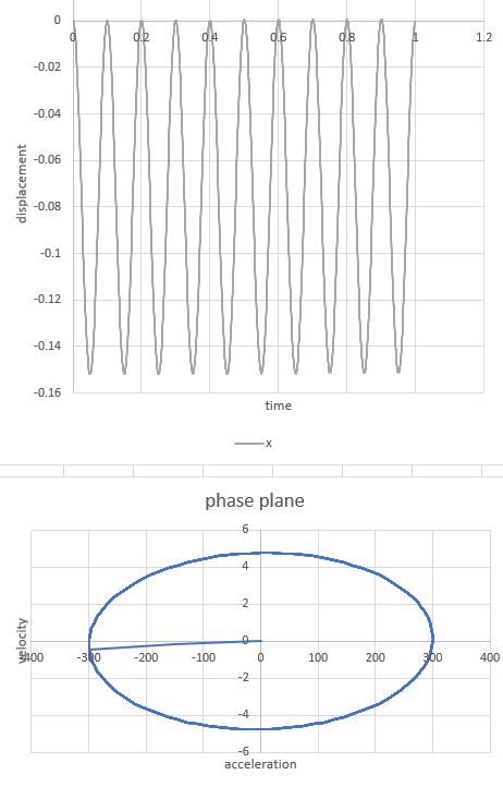

I believe the "k" you are looking for resides inside the machine. It's not an external spring pushing/pulling the machine along the rails. The motor frequency excites an internal natural frequency. The large periodic forces developed moves the machine back and forth along the rails. The motion of the machine mimics the oscillating internal spring/mass/damper.
For the graph of the motion versus time you have in your original post, if you want the initial displacement to equal zero I believe you can just the shift the curve left or right till the displacement equals zero at time t=0.
"for the graph of the motion versus time you have in your original post, if you want the initial displacement to equal zero I believe you can just the shift the curve left or right till the displacement equals zero at time t=0."
This is wrong. OP shows formulas derived from a homogeneous (undriven) equation; you'd need to solve the same equation set equal to the forcing function (which is the driven vibration of the system).
See my above post for the characteristic equation governing the system, which is what you'd have to use to solve it analytically.

That equation you showed includes Coulomb friction, it isn't the equation for Coulomb friction, which is why you are having trouble finding a solution. The equation you found is for a simple spring-mass with only Coulomb friction removing energy.
onatirec is correct, though I would have expected a summation over all the individual masses and all their individual spring elements and all the internal and external damping coefficients and all the various excitation sources.
Th motor is putting energy into the system in complex ways and the way to understand that will be via complex equations.
See for an example to deal with a simplified solution.

What makes this problem more interesting (i.e. even less practical to solve analytically) is the effect of the vibration not only on the movement in the direction you're interested in, but on the normal force which drives the dissipative friction force.
Something like:
m*d^2x/dt^2 + (mu)*m*g*F(t+phi)*sgn(dx/dt) + kx= F(t)
Where F(t) is really a collection of speed dependent excitations (e.g. e/m slotting, bearing frequencies, mechanical imbalances, etc) which are weighted by the structural resonances and produce effects roughly 90 degrees out of phase on each the normal force and force along the axis which it walks...
Very interesting problem, but you could probably write a dissertation on modelling and solving it analytically.
