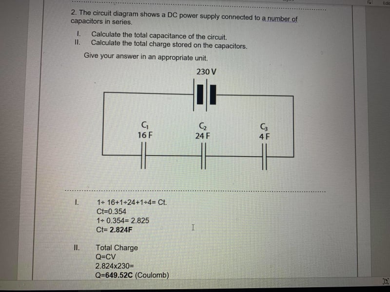

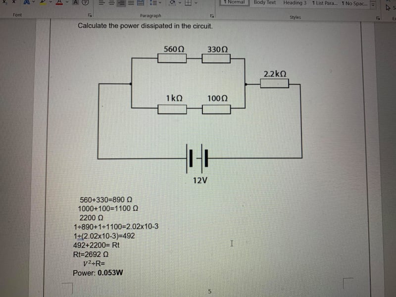

If any are incorrect please let me know[bigsmile]
I do see at least one error, but we're not here to do your homework so that's all you get.
@lionelhutz
atleast let me know which one it is.. i wasnt asking for you to answer it anyway haha

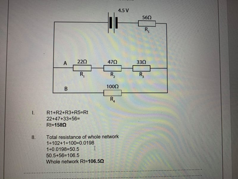

Your first image is of a series parallel circuit, it's not clear what you were trying to do, since the problem statement isn't included. Your first answer makes no sense in the context of the second part
TTFN (ta ta for now)
@IRStuff oh yes i forgot to show you the first part of the question
this is the question for it, sorry
Ive checked it and made some amendments so hopefully it will be all correct! :D
I come to the same conclusion as TRstuff.
Thank you for your effort to solve this on your own.
Hint: Locate and mark your branch points.
