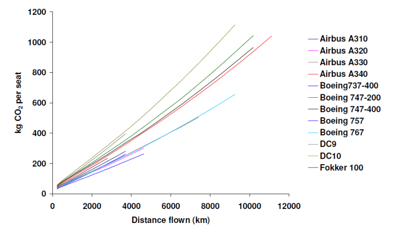

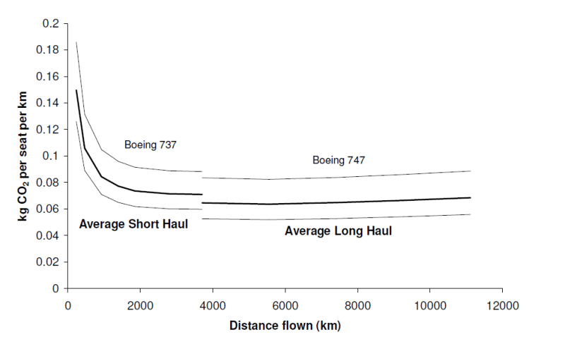

OK, I get the TLDR; so since you guys are soooo lazy ;-)

Hmm. A 737 gets at best about same C02/km-seat as my '82 Benz 300TD, single occupant -.08 kg/km-seat for the benz. No movie or peanuts included though.
Which generation 737 and 747, there's only 40 years or so variation in engine technology for both those aircraft.
Edit: and how I have read the first charts legend, so -400's for both so 90's engines.
