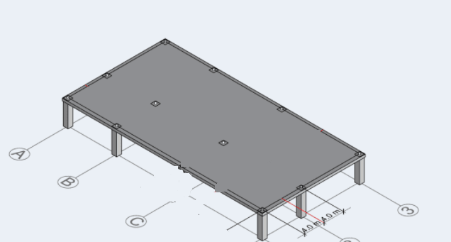

Hi all,
I wrote a blog post about calculating tributary areas of columns. Probably targeted more towards students and graduates, but thought someone in here might find it useful anyway :) Feel free to check it out or let me know if you have any comments or thoughts.

Your blog post is good. Some additional ideas to expand on it:
1) Another example with oddly spaced or non-orthogonal columns.
2) A extension from "Tributary are" to "influence area".
3) Other Odd cases. Maybe something like the following image where one of the edge columns is removed

1) Firstly, I love what what you've accomplished with this technologically.
2) The app has one critical limitation that I didn't see mentioned in your blog: it does not account for floor system continuity over columns and walls and, therefore, will underestimate the true tributary area in many situations. It may well be that's an acceptable approximation in some scenarios but, given the nature of the tool, I feel that it is important to mention this in the associated documentation.

This is neat, but as Kootk mentions the actual load going to each support depends a lot on slab continuity, as opposed to simple nearest neighbor calculation.

1 and 3 are really great ideas, thank you! I think these might become separate blog posts. For suggestion 2, can you elaborate a bit more on what you mean?
Thank you KootK, really appreciate the feedback. Do you mean that in such scenario the support moments would affect the total accumulated area? Could you further explain how the mechanics around that works? I want to make sure I fully understand your point, so that it can be reflected properly in the documentation, as you say.

Thanks a lot for the feedback Tomfh. Could you please help me understand how the continuity of the slab affects the tributary area? Does this have to do with moments induced if the slab isn't "released" at the supports? I am aware that slab directionality (like one-way systems) and column stiffness will affect the tributary area, but how does slab continuity affect it?

Tomfh said:
Internal column can attract more load:
You are right. The difference between continuous vs discontinuous could be up to 25% (0.625/0.5 = 1.25). However, I'm afraid that there is nothing that can be done to account for this with the current geometric approach that Tribby3d uses. Is this a deal-breaker in your opinion? Tribby3d is meant for early-stage approximations - FEA would be more appropriate if exact results are needed. Either way - I'll definitely improve the documentation to clarify this.

A lot of buildings are designed using the tributary area method without any real consideration of this effect :)
Sometimes multipliers are used as a simple way of accounting for the effect, whilst still using tributary area method. Eg multiplying the first internal column load by 1.15 or 1.2 (depending on scenario).
We always increased the first interior support by 10% to accommodate the increase in area... also used 0.9 for the exterior columns.

1) Tomfh seems to have explained all that pretty well while I was sleeping. Do let us know if anything remains unclear however.
2) Some other situations that can result in interesting, and perhaps spurious, results include:
a) Cantilevers.
b) Alternating long and short spans as can be the case with rack storage and isle/stall parking layouts.
In the extreme, these things can produce what would effectively be negative tributary areas (uplift).
c) As with all tools used professionally, it will incumbent upon your professional users to employ their own judgment when deciding whether or not Tribby represents valid approximation. I think that your path forward with something like this is to be user friendly in making it reasonably clear what Tribby does and does not do but, at the same time, don't go nuts with hand holding.
d) An interesting case might be the one shown below from your blog. A useful approach for your blog might be to take some of these interesting cases and run them with a true FEM program to see how they compare to your Tribby results.
