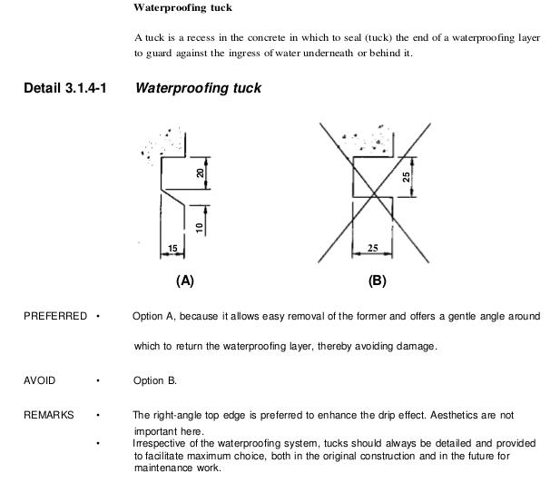

@Mike_311: Good point about "bad" ones - these would be rather rare; what I had in mind are publications such as CIRIA C543 Bridge Detailing Guide (UK). The focus is obviously on the "good", but they actually do show some side by side examples of good v. bad details - here is an example:
CIRIA C543 Bridge Detailing Guide (2001, UK): Link
