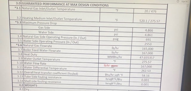

I am looking for help calculating the condensate temperature being sprayed to outside atmosphere via a leak. The source comes from a tube and shell heat exchanger using HP steam to heat natural gas. We have a leak on the steam side and management is asking to attempt to tight the flanges of the heat exchanger heads, while it is under pressure. Thankfully for safety reason this is no longer being considered I am curious of the temperature that the condensate will be if some one had attempted to work on this steam leak while it it spraying to the atmosphere. This isnt the first time this issue has came up with this heat exchanger, previously the gasket has been cut aprox 1" in width sometimes in a few different spots. Again not attempting to work on this equipment while under any amount of pressure or temperature im just curious so I can present some good data to our safety department and managers. Management wanted to reduce pressure from 1858 psi, 530 F to 500 psi, 452 F and 500 psi,385 F. i would like to know the calculation or how to calculate the condensate temperature when the exchanger is at 500 psi , 452F and 500 psi 385F? Thank in advance.

Thanks for your reply, the condensate that I am referring to is after the steam has leaked to atmosphere and then condensed. I am attaching the exchanger specs as well as a video of a similar leak that has occurred on this piece of equipment. The side (tube side) of the exchanger utilizes natural convection.I cannot quantify the mass flow rate of the leak.
When steam escapes from the leaking gasket, this is an isenthalpic expansion. So lookup steam tables and match the enthalpies at P1 and at atmospheric pressure. Most likely the steam will all be superheated at 1bar abs, but may within a few seconds, cool and condense to 100degC.

Theoretically, considering leak of condensate in 2553psia and 276F to atmosphere, outlet temperature will be 100C.
93% of water will be in vapor phase. (calculated by passing water through a valve from operating condition to atmospheric pressure in HYSYS)
Other pressure and temperature conditions which you have mentioned, will effect on % of vapor and liquid, but the temperature will remain 100C.
