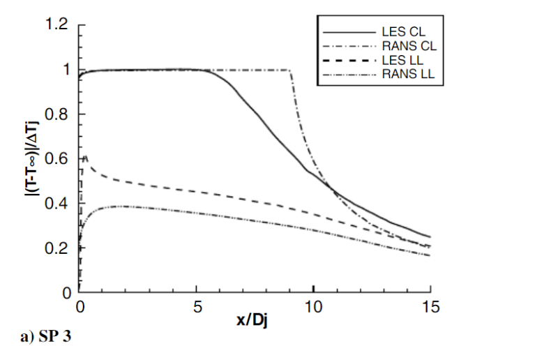

If an approximate but quick estimation is require please refer results from a CFD study(Ref Prediction of Turbulent Temperature Fluctuations in Hot JetsJames R. DeBonis∗NASA John H. Glenn Research Center, Cleveland, Ohio 44135DOI: 10.2514/1.J056596)
x=distance from jet origin.
Dj=Diameter of jet (5 mm assumed)
Tinf=atmospheric temperature=30oC (assume)
ΔTj=Jet temp-atmospheric temperature=135-30=105 K
So at about 15*5=75 mm distance the temperature is about 0.4*105+30=720C
Therefore it is expected that at 1 m distance the temperature will be much less than 600C
