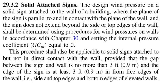

I started this line of thinking when an old boss of mine told me that a sign attached to the side of a building wouldn't experience any negative wind pressures due to the exact same reasoning. I disagreed, and ASCE 7 had some guidance which agreed with my position. See ASCE 7-16 29.3.2.
It is interesting that this provision even applies when there is up to a 3 foot gap between the wall and the sign.

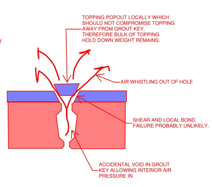

Is there truly no air pressure on the underside of a precast topping? I suppose this depends on the keyway grouting and how well that forms an airtight seal. It would seem to me that there could be locations where an airtight seal is not achieved, and where the topping could see air pressure from below? May be a moot point considering the magnitude of the bond strength available.
I think that's probably right, albeit probably still not a cause for concern per the sketch below.
Fascinating, thanks for sharing that.
Allow me to posit an alternate interpretation of 29.3.2. Don't interpret this as me claiming to "know" anything on this. It's just me spit balling a little devil's advocacy in search of some insight.
29.3.2 SOLID ATTACHED SIGNS - KOOTK ALTERNATE INTERPRETATION
1) What's it take to have no air pressure behind one of these signs?
a) Sign in general contact with wall? Nope, there would still be plenty of tiny air filled gaps between sign and wall.
b) Airtight seal around the perimeter of the sign? Nope, that would just trap a pocket of stagnant air in the small spaces between the sign in the wall.
So, since it's effectively impossible to not have stagnant air behind the sign, we're going to explicitly tell you that you DO have to design for such and such pressure in these situations just in case folks try to get clever with the whole "there's no air behind" the sign thing. The only out would be to tell folks that their signs have to glued to the wall over the entire contact interface in such a way that no air pockets were left and the seal was airtight. Obviously, that's a whole lot to ask.
2) So what air pressure should be used?
a) Since the air behind the sign is effectively zero velocity and at the stagnation pressure when a gust comes along, let's use the C&C loading with the interior pressure set to nil.
b) Since the air behind a sign will be at stagnation pressure up to 3' separation, let's include those scenarios here too. I have no idea whether or not 3' is the distance at which the stagnation pressure argument is valid. I'm totally speculating with that.
