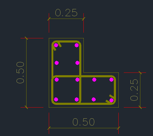

How to assign L shaped column into a model?
I am using ETABS 2013 and i dont know how to assign it. I tried with section designer and nothing happen when i assigned it to the model.
and i tried with section shape: Concrete L, i cannot draw it precisely. It was too far from the midpoint of L-shaped column
Draw two walls to make the L Shape? Assign each wall a single pier label for forces?
is that possible to draw a wall as a column?
What is the size of the column? ie, thickness and length of each leg that make the L shape?
This is the dimension of my column
