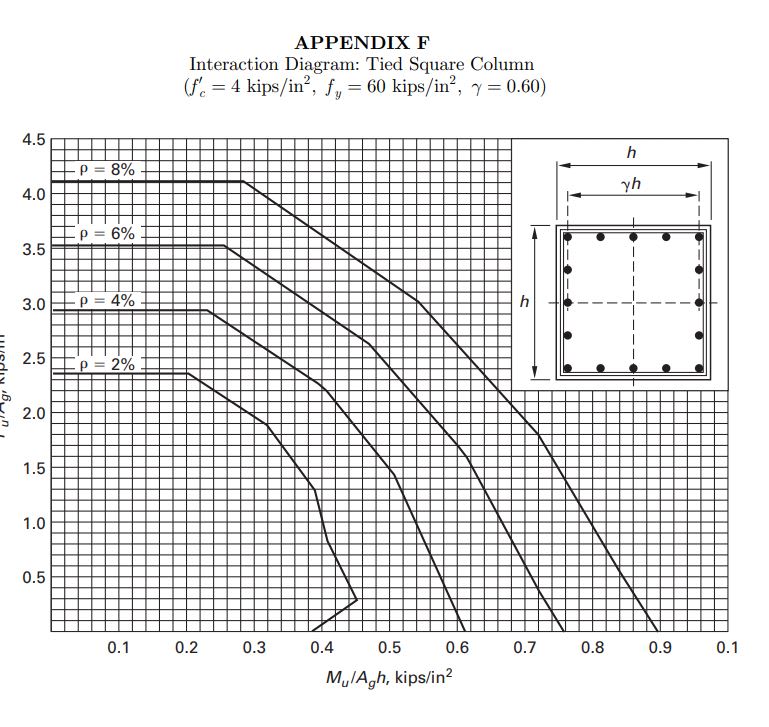

Hey everyone. I'm taking the SE exam in April and I can't fine a decent set of RC column interaction diagrams. I'm having trouble find some that are useful. I even bought the CRSI design guide. There isn't enough separation on some of the diagrams. For instance the 16"x16" shows the curve for f'c of 4ksi and then jumps to 7ksi. There's a large gap between those two values.
Does anyone know where I can find some?
Thanks,
Joe
In Canada we use the Concrete Design Handbook, which has a number of interaction diagrams with fc` jumping by 5 mPa (fairly typical of mixes here. Would be about a 0.75ksi jump per diagram). I've attached a typical page. But the diagrams are based on bar layout + fc` so if you are looking for a specific configuration you will have to provide it to us. If you need all of them just buy the handbook!

Thanks KootK!
Also thanks to skeletron and TheDayWalker. Neat to have access online when handbook is not...handy

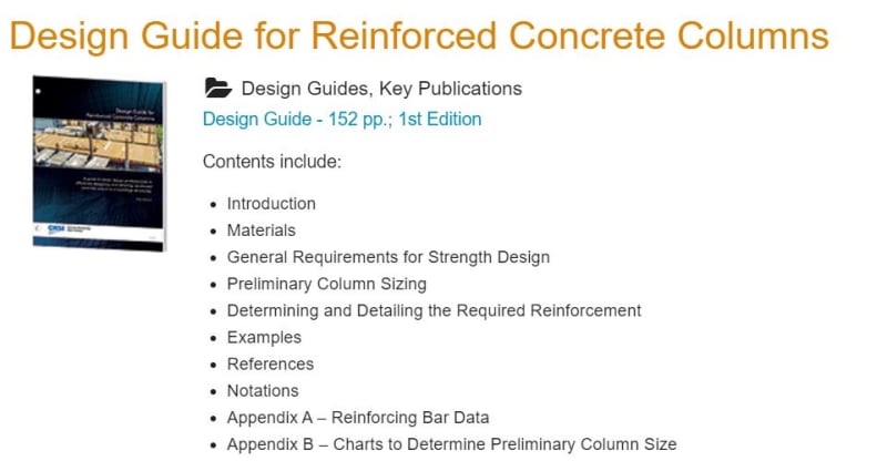

Enable. The instructor I had for my concrete review course recommended the CRSI 2008 10th ED. The only physical copy I can find cost $800 on Amazon. I then called CRSI to purchase the pdf version. I was told that the device it was downloaded to was were it would reside and couldn't be moved. As if computers and phones don't die and or get replaced. I then also informed that I could pay extra for a multiple license for up to 3 devices. The kicker was that I wouldn't be allowed to print from the PDF. I wasn't going to waste my money.
Daywalker, you rock and thanks a ton! I bought the design handbooks, but there weren't a compilation of the column diagrams. Heck, I didn't even know about the Design Aid.

If you want CRSI for columns, the document to have would be the one shown below which is essentially just the columns chapter from the big book, isolated and updated. $50.
