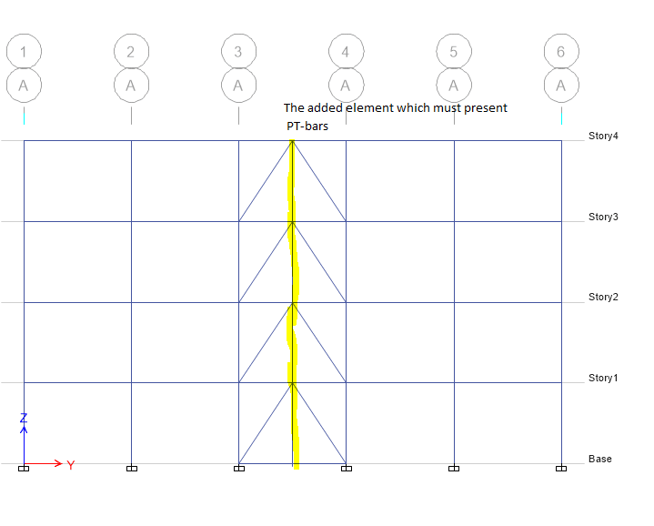

I'm trying to model a post-tensioning bar in my structure in Etabs as is shown in the figure, unfortunately, I'm not able to find the option of modeling a post-tensioning strand in the software, I was thinking if I can model them as external Tendons if no would you please give me any thoughts about how to model that?

about the PT bars, I want to model them in Etabs along with the height of the structure as it is mentioned in the previous figure in Etabs or Sap 2000 Software, however, when I was trying to find this option in both software I couldn't find this option to model them.
My main issue is how can I model this element PT bars in the software, would you please give me your suggestions.

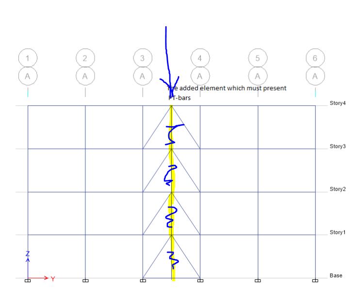

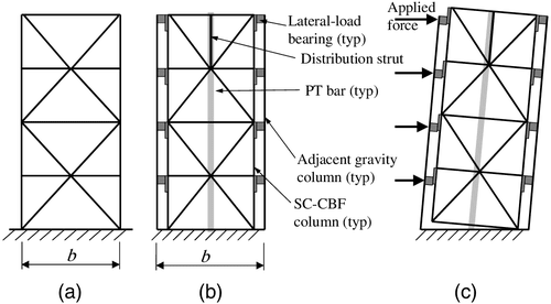

Yes as you said, to explain more I'm providing a PT bar along with the height of the structure in order to increase the lateral resistance against the seismic loading (Rocking Frame Structure), during the earthquake these element PT bars will get stretched as we can see in the next figure.
in the etabs i want to model these PT bars but I'm unable to find how I could design that.

I don't understand your question on "how to model the PT bars". Maybe I don't see the issue correctly, but wouldn't be model connecting elements between notes (as the yellow line in your last sketch) with end releases be suffice? You might need to elaborate more on the difficulty/dilemma you are facing.
For some purposes, you may be able to get useful results by just replacing the PT bar with the load that it will apply at its upper anchorage. For the post-tensioned lateral systems that I've had exposure to:

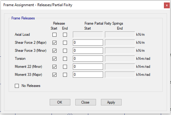

I just tried to model the PT bars with a truss element and with the same Area as the PT bars however, when I was modeling I release the forces from the element and ran the analysis but the stresses coming from the gravity load some compression forces appear on the PT bars as you can see in the next figure. however, I believe that the PT bars work only in tension. would you please correct me ,
this is the option for releasing the restrains, I selected the elements and use the selected elements.
Check user manual to see how it specifies "tension only" element, or spring. If it has command available, then your problem is solved by follow the instruction. If only the latter is available, then follow the instruction with equivalent spring constant calculated by k = (EA/L)ELEMENT. Please note that I don't think the PT bars will offer much help in your case due to the very stiff nature of the braces. May I ask why you want/need to incorporate PT bars in your mode? KootK's suggestion may yield satisfactory solution, if none of the commands are available.

Also you need to turn off the meshing of the PT line element as in the screenshot above it is attaching analytically to each intermediate floor as the force is changing, if you turn off the internal meshing it will only be attached at the top and ground if you draw it as one element top to bottom. My understanding was it is only attached to the top level and ground in these types of rocking systems with external restoring forces provided by the PT, so you need to achieve this in the modelling by having it effectively disconnected at intermediate levels by playing round with the meshing. Otherwise you'll have to model it offset form the plane of the brace somehow (but keep it simple by exploring the meshing first).
