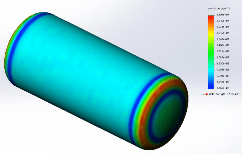

I was looking at 60 gallon tank:
Quick FEA seems okay with 1/8" wall thickness .. but this is overly simplified model.

The FEA analysis you have done (presumably with external pressure) does not indicate any deflections. Usually FEA software do not have the facility for checking the elastic stabilities under external pressure or compressive loads. So you may get a stress lower than yield stress but the vessel may be elastically unstable and hence buckle. This needs to be checked according to Sec VIII-1.

From the quick FEA with 1/8" wall, max stress is 24 Mpa (3.48 ksi).
General fatigue strength is 40% of ultimate tensile strength.
Roughly 170 MPa (24 ksi) for steel from my research.
The stress seems to be well under its fatigue strength... would it still be a deal breaker?
@goutam_freelance, oh. I should re-calculate the stress.
What eccentricity did you apply? Have you checked buckling criteria?

I am curious as to how the tank will be evacuated and refilled so rapidly. The pressure swing isn't much different than pressure vessel use, so there is that, but I also note that, for example, a soda bottle can see 150psi with no problem but cannot withstand more than 1 psi vacuum. See what happens if there is a flat or dent in the long side of the FEA model to be sure it's stable. (I now see that Ed had a similar observation.)
