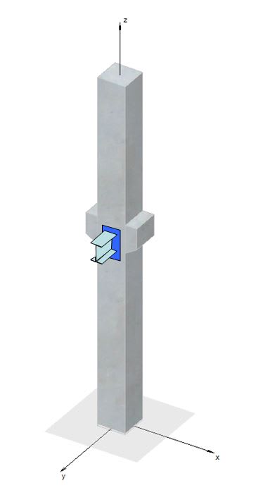

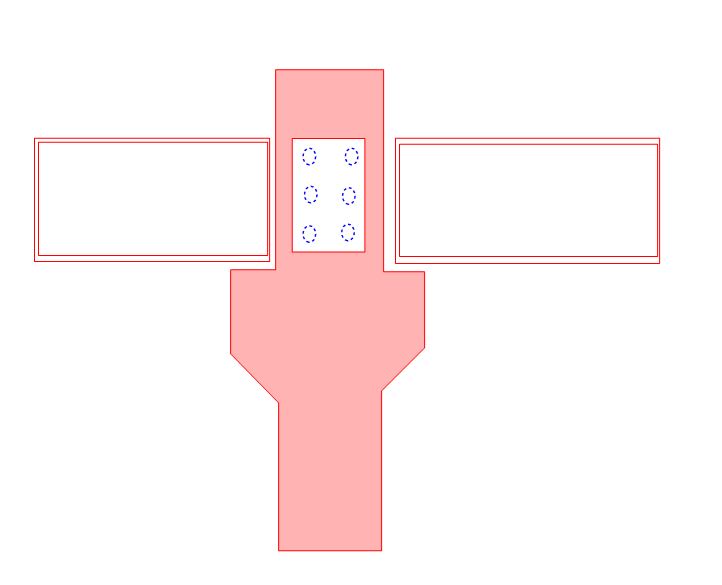

I'm picturing something like this.

You can use typical concrete corbels from two sides. On the other perpendicular sides, you can use rebar plate cast into the concrete and then weld steel bracket (yard welded) to it. To minimize rebar congestion, lower the steel corbel slightly so that the tension corbel steel from the two sides is at different levels. Correct the levels later by welding a plate to the top of the steel section. See screen shot below. Keep in mind when designing the column that the maximum column moments do not happen when all four corbels are loaded with the live load.
