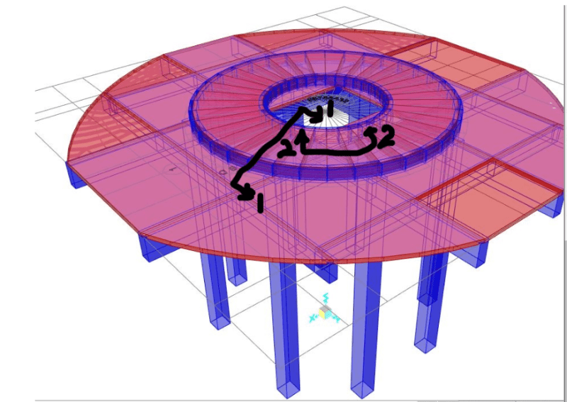

I want to add a circular beam and slab section on the top of the existing slab. But i am confused on how to create a connection between this two things. Should we assign constraints or is there some way to model it? said:
The beam and slab section would seem like this

Physically you shall provide shear connectors between the ring beams and the slab to make it a composite structure. On computer modeling, IMO, you could use rigid link between these two elements.

Thanks for your reply. Are you talking about the constraint? As the new beam slab element is supported on the slab i am not sure on how to assign constraint in such scenario.
Pretty interesting structure you got here. What’s the point of adding the slab/beam? Does the existing slab not have sufficient strength, or is it some sort of architectural feature?
My attempt below:
Modeling offset shell elements with rigid links would be quite difficult (impossible?)if that’s how you are modeling your slabs. You could either model the slabs as one layer of shell elements with thickness properties equal to both, or if your program allows you can “glue” or “weld” the faces of the shells together, offset beams could be connected together with rigid links.
The major assumption you would making here is that there is sufficient mechanical anchorage to allow the slabs to work as one composite. That would need to be checked by hand.

I provide the constraint at the lower beam and the new beam and slab. however, the two slabs are deforming in different method on analysis. Is there any way to connect two slabs together?

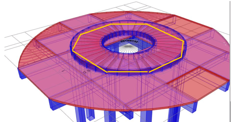

Presumably if the existing beams can take the vertical load in that arrangement, then do you need to connect it with anything but some nominal drilled in bars. Or do you need it to be composite to take the applied new loads and that the question over how to connect to act compositely? Any uplift from the tank or whatever it is might change this, but need more explanation around the arrangement to know this.
I can't help but think it would be a whole lot easier to have a series of straight beams/cages supported from the existing beams as shown below (and similar to the internal hole (not shown on sketch))? Slab just spans between these new beams or cantilevers past slightly?
Then just model the applied loads on the existing structure. Design new slab for applied loads, existing for applied reactions. Keep it simple, any composite action you get is a bonus.
Actually looking at the plan you just attached while I was writing last reply, if you were to go with my suggestion, all the new beams can be directly over the columns. This seems far simpler than the curved cages you are implying will be used via what has been modelled?
