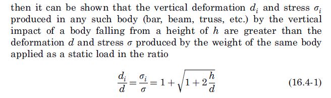

Let me explain some concepts;
-If the drop object and the supporting ( beam, rod , in this case plate) fully elastic and no energy dissipation, the dynamic load is a function of static deflection
Pdyn = W ( 1 + SQRT (1+2h/ Δst) W = weight falling from a height h. Δst = is the static deflection for the weight W.
- The following snap from the Roark’s Formulas for Stress and Strain based on the above formula..
di and σi are deformation and stress for the impact loading.

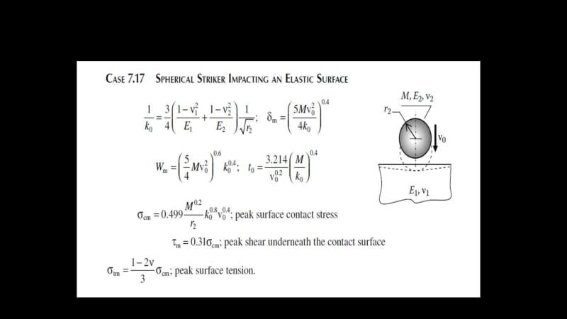

- In your case, restitution for natural rock and friction with the surface reduces the impact stress. With a conservative assumption , spherical rock striking to elastic surface ;
The above is a snap from the book Formulas for mechanical and structural shock and impact by Szuladzinski .
You may provide more detail to get better responds. Getting a thicker plate is not always the solution.
