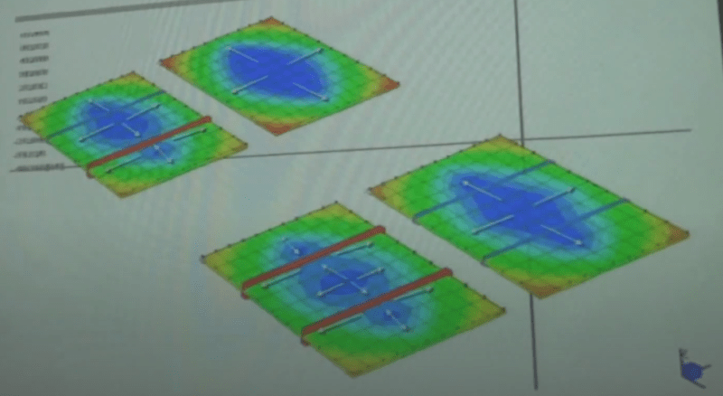

And I should have included this photo below earlier. Someone showed me that. There are two beams and 4 comparisons. The rigid beam is represented by a red line and the flexible beam is by the blue line.
In figure 4 (bottom-right) both flexible beams bend together with the slab (i.e. no/very little slab hogging moment at beams in the direction perpendicular to the beam). Most designers I know including myself (btw I am using 2D software) will not take that into account and will just always simply assume the beam is rigid and there is slab hogging moment at beams(just like in figure 3 (bottom-left). I think our assumption should be ok for ultimate strength design although it will require a lot of redistribution. I am worried that the slab will crack a lot more than I expected at service with a different pattern. That's why I was wondering when to consider a beam is rigid and how to account for that. I guess FEM is the way to go and for 2D, I will just use KootK's Canadian Code formula and steps.
