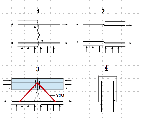

I think my previous responses are shady, as there is no theory, nor code provisions to back up those comments. I don't want to mislead you, but to offer my thoughts on this matter for you to judge. Sketch below demonstrates that. Figures 1 and 2 are self-explanatory, note that the reinforcement will be mobilized once the concrete blocks start to slip. Figure 4 is a baffle block on slab with dowels for shear friction, which is quite common on hydraulic structures. You really have to give a hard look on figure 3, ask how the slip is going to occur, what components can be utilized to resist the shear force, and to what extend. Unfortunately, there is no clear cut answer to each of those question. I won't spend any time to think about how to justify a construction mistake, if there are simple solutions available. I wish you luck.

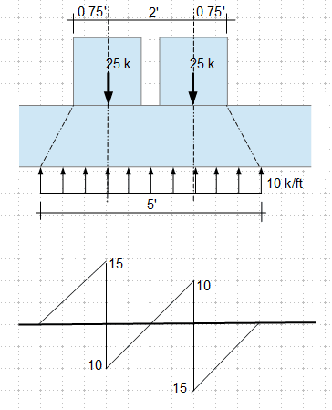

The CJ location provided by the contactor is not reasonable.. The expected location of CJ is at a distance L /4 ( L is the span)... However, your approach is also not reasonable..

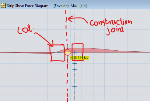

Apparently the shear V= 413 kips at just under the column axis 6. The CJ provided between two columns and the shear which will be experienced by CJ should be less than 413 and would be around zero if the column loads are similar.
Moreover, say your figure is correct, what is the reason for checking shear friction for 1 ft width ? if d=54 in. you may check for a width 3d.
The one way shear is checked at a distance (d) from the column face and for two way shear at a distance d/2.
Does this respond answer to your question? If not, you may perform the mat analysis with more refined mesh and check the shear friction for a width say 3d .

Share the same thought here. For example,

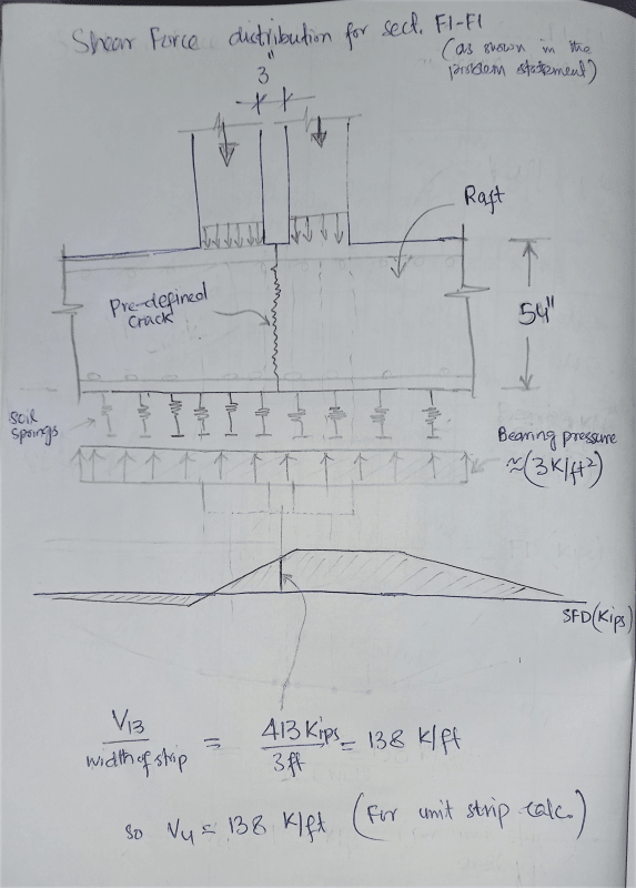

But Here it is a predefined crack at which shearing off the two opposite concrete faces is very much possible to occur at that location.
Dear, r13 and @HTURKAK The way you visualized the load distribution is quite good but more like for a rigid system and i don't think it clearly represent my problem, However the problem is that it is SOG(Slab on Grade) as in the figure below, the shear caused by these vertical loads will definitely make it zero but not in between the columns while it will be much away from the columns, as actual distribution of shear force is shown in the below figure and from the CSI SAFE Results

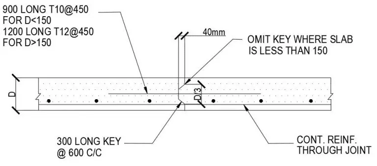

When a construction joint is required in a mat foundation, my preference is to locate it at centre span where shear is minimal. In addition, I specify provision of a key about 1/3 the thickness, and some big dowel bars in the middle of the key. Belt and braces approach, for sure, but a mat foundation is not to be trifled with.
Dear @hokie66, Thank you for your response. In case of construction won't it be good to provide key at L/3 (where minimum V and BM) with a key and not in the middle as there is max BM in middle?
You are suggesting to provide key of this type? is the key would be a little odd if extra dowel bars are not provided in the middle?

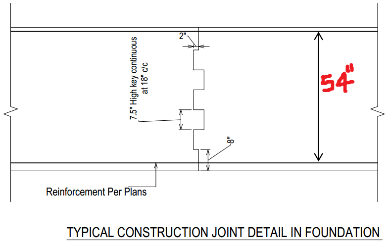

As the mat foundation thickness is 54" so won't the shear key shown in the figure below, more suitable, to have a more roughness and all that without a dowel bar in the middle?
I know some folks like the L/3 arrangement, but I would rather see it at midspan. Theoretically minimum shear, maximum moment. The moment is taken by the T-C couple, which is unaffected by the joint.
The sawtooth key can work, but is a lot of extra labor. I would just use a single key 18" deep, with some big deformed dowel bars central to the key.
Others will have different ideas, but that is the way I have detailed construction joints in mat foundations for many years.
