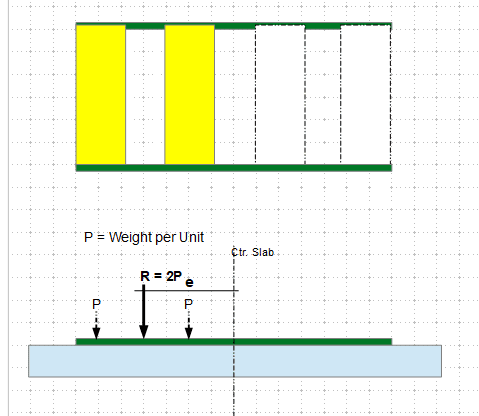

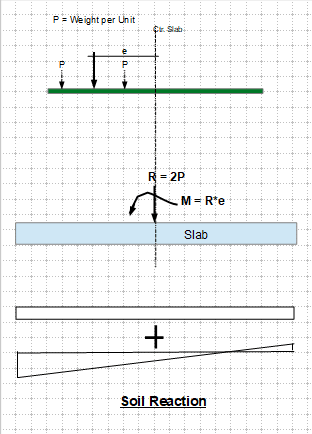

Hope the sketch below helps.
R13 if you have a moment could you explain what you are relaying to me in the sketch

The sketch below shows the general concept of the effect of the eccentric load on the slab. I assume you have a slab on grade system. If so, you need to check soil bearing strength, as well as the stress in the slab. Since you have used full load in sizing the slab, the eccentric load case might not be govern, but I still would check to ascertain the design.
Ahh, I see
I will look into this aspect.

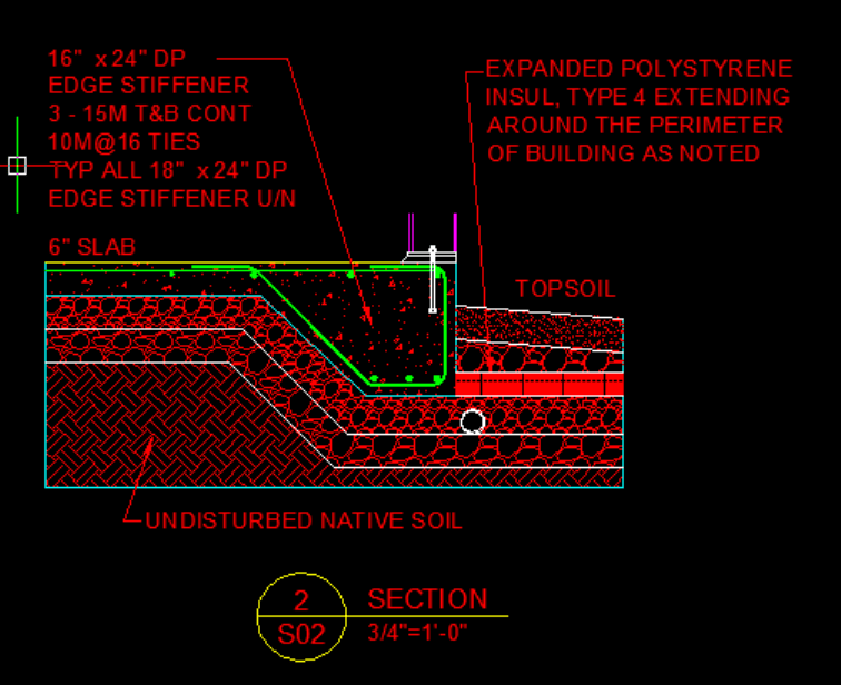

Soft soil or frost heave issues? Looks not too bad. I would use bars @ 16... easier to walk between and add edge reinforcing as shown below. If your loads are light, the slab could be reduced to 5" or 6". You include details that I don't usually include and sawcutting at 12 hours is too long... a max of 6 or 8 hours. If you wait 12, you may as well wait until the microcracking has finished and sawcut on the cracks.

The bottom of the slab (footers) are set at 12" below grade in this project, The code in this area requires 6" (mid-Atlantic region). So I think I am covered for frost heave.
I like the way you rolled the stirrup into the upper grid, I may borrow that vs the dual hook setup I show in my details. The design I show in the attached thread files has a #3 stirrup (edge stiffner), What bar size are you using in the provided detail?
What does "DP" refer to in the provided detail?
Does undisturbed mean zero compaction?
I like the idea of 16" for ease of construction, good tip, Thank You for your feedback.
Deep...
Yup, generally native soil is fairly sound, whether cohesive or granular, and for the project I lifted the detail from it was firm clay.
I've done hundreds, or thousands of this type of stiffened slab... I have standard sheets with notes, edge details, corner details and sawcuts... I'll try to dig one up and can post the *.dwg file... Use 6mil PEVB underneath and rfg is 2" from top... and chaired. I never use WWM for rebar.

Those are some nice details, simple but add a lot of value
