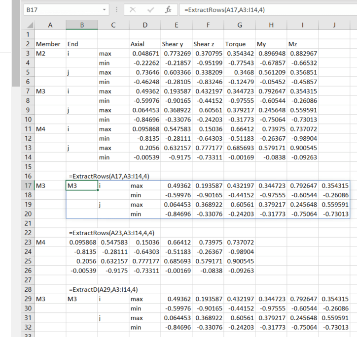

If this is going to be extensively used, a VBA UDF is worth looking into. The screenshot below shows two alternatives:
ExtractRows(RowID, DataRange, Rows = 1, FirstCol = 1, Cols = 0)
or ExtractD(same input)
The two functions are the same except ExtractRows steps through the first column until it finds the RowID, and ExtractD creates a dictionary of RowIDs and the associated row number.
They both return an array of the number of rows specified in Rows (default 1), starting at FirstCol (default 1) up to the end, or the number of columns specified in Cols. Note that the Rows value should be equal to the spacing of the Member ID text.
With the code as is I doubt there is any advantage in using a dictionary, in fact quite likely it is slower, but it would be easy to extend the code to read a list of Member IDs (not necessarily sequential), and return a single table for all of them. In that case the dictionary would definitely be quicker.
The functions use the new Excel dynamic array functionality. To use in older versions of Excel they need to be re-entered as array functions.
The spreadsheet including open source code can be downloaded from:
If copying and pasting the code to a new spreadsheet note that the ExtractD function requires the Microsoft Scripting Runtime to be enabled, under the VB editor Tools-References menu.
Doug Jenkins
