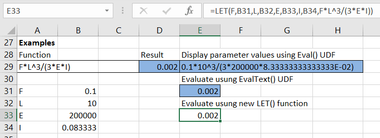

electricpete said:
Sounds like a challenge....any volunteers? (mostly kidding). Oddly enough my company's Excel for Microsoft 365 MSO 32-Bit doesn't seem to have Let() yet, although I imagine it's just a matter of time.
My Eval UDF does a similar job to LET, but (at least in my opinion) much more conveniently:
In the screenshot above the function in A29 (F*L^3/(3*E*I)) is evaluated in D29 with: =eval(A29,A31:B34).
Using LET (cell E33) the function is: =LET(F,B31,L,B32,E,B33,I,B34,F*L^3/(3*E*I))
This is my first time using it, but it seems that:
The parameters must be entered directly in the function; you can't refer to a cell address
The values can be a cell address, but each pair of symbols and values must be entered separately, you can't refer to a spreadsheet range listing all the data.
The function to be evaluated must be entered directly in the function.
For more on the Eval function and download link see:
For the unit aware EvalU (and other unit conversion functions) see:
