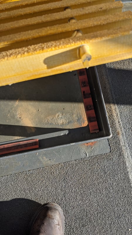

Gratings tend to chip any coatings underneath them. I use adhesive backed silicone tape to protect the coating. Neoprene would also work and is less expensive.
Also consider the use of fiberglass gratings if height allows.

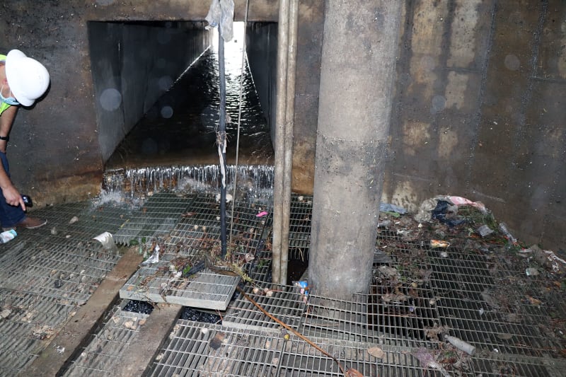

See below photo. All of the chopped-up/askew steel grating is what we are looking at replacing with aluminum. (the beams underneath also have to be replaced/modified).
Under a low flow situation, there is a small continuous stream of water entering the wet well, but in a rain event, the whole 20ft deep well will fill up water.
Tape works fine for me. Treat the surface as if you're going to apply any coating, do some surface prep.
Sorry for bad lighting:
