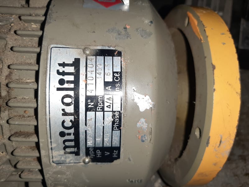

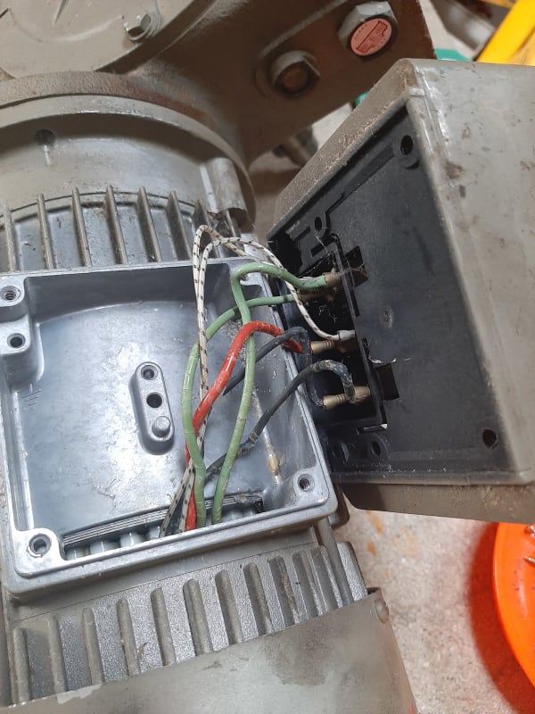

I have a microlift roller shutter motor and I need to wire it up can anyone help.
The motor has 7 wire ??

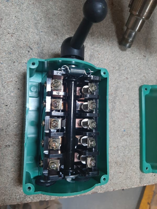

Do have a drum switch too

Do a search on “IEC single phase motor connections”. You might find something useful, but to be honest, that looks to have something proprietary to it because there are more wires than are typically needed.
There may be internal limit switches, but the OP has not given enough details to work with, despite the pretty pictures.

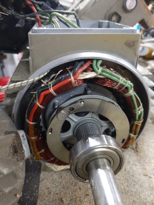

It may be a wasted winding motor.
One start winding and two run windings, one used for forward and the other used for reverse.
Or it may be something else.
Seven leads is not common.
Bill
"Why not the best?"
Jimmy Carter
Curious the Green and red wires are much larger than the black.
The striped are the start switch carried out of the motor.
Why are you showing the drum switch? Did actually come with that motor?

I am guessing;
Green are the start winding.
Red is a common run winding.
The black wires are forward or reverse. (only one used at a time, hence "wasted winding")
We can't be sure without some testing.

How would you wire the motor
Does the switch transfer connection to fatward or reverse windings or does it stay connected all the time ?
